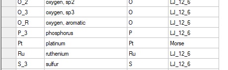

I'm attempting to add Platinum atom to the FF documents. Here are the step I'm following from the 1) "Help > Working with forcefields > To create a new forcefield type" as well as 2) the tutorial Using MAterials Studio to edit a FF" p. 257. First I import the standard Deriding into Project explorer, rename it to "Dreiding_edited". Then got to last row of "Types" tab and add Pt as you may view in the image attached.

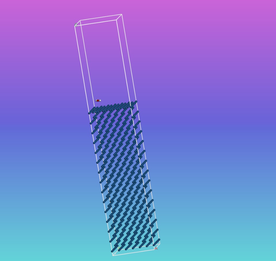

Afterwards, I change to xsd contaning Pt atoms and water. (image 2) and do what is indicated on p 257 of tutorial:

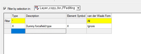

Q 2) As I head over back to "Types" tab, check the checkbox "Filter by selection in" I see no atom types in there (image 3). Coudl you assist me figure out the issue?
