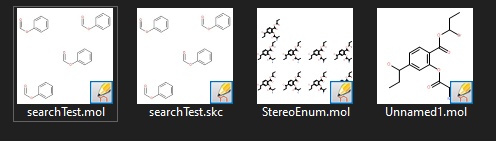

BIOVIA Draw 2022 has the ability to render thumbnails of structure files (see below). If you find its not working for your installation this is how I fixed mine on Windows 10:
Open the command console in Administrator mode. Then...
C:\WINDOWS\system32>cd C:\Program Files\BIOVIA\BIOVIA Draw 2022\bin
C:\Program Files\BIOVIA\BIOVIA Draw 2022\bin> RegisterExtensionDotNet40_x64.exe -i LogicNP.EZShellExtensions.dll StructureFilePreview.dll
Running as : 64-bit
Processing file : C:\Program Files\BIOVIA\BIOVIA Draw 2022\bin\LogicNP.EZShellExtensions.dll
Processing file : C:\Program Files\BIOVIA\BIOVIA Draw 2022\bin\StructureFilePreview.dll
Assembly registered for COM Interop
Result in Windows Explorer:
