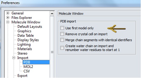

1) pdb files are intended only for multiple conformations of a single structure (think NMR structures).  As a result there is not a method to save the names of different structures in a standard format pdb file.   In my tests of four different molecules at all four structures _are_ saved and _do_ read back into DS fine.  However, the molecule names are taken from the file name with the index number appended (original molecule name is lost).    But, note, there is also a preference that will ignore all but the first molecule in a multiMolecule file containing multiple molecules.

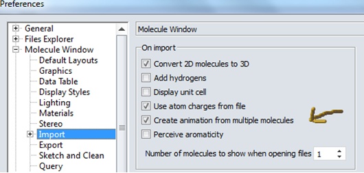

There is also a DS preference that will cause the different entries in a  pdb file to be loaded in as different "Conformations" -- similar to  what you would get if you looked at a molecular dynamics trajectory.
(in case you ever wanted to do that):
Preferences / Molecule Window / Import / Create animation frm multiple molecules :

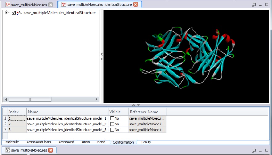

If you have this option selected  AND the structures are the SAME molecule with only the conformations changing then you find that one molecule is loaded that contains one "Conformation" for each of the frames in the input file.  In this mode only one frame can be viewed at a time but the results can be processed as if it were a trajectory.  Note the “Conformations” tab in the data table at the bottom of the image shows the three input molecules (conformers).
NOTE, this preference should ONLY be active if the molecules in the file  differ only by conformation, otherwise the results will be  unpredictable.  Therefore, it should always be turned off when not  needed.
