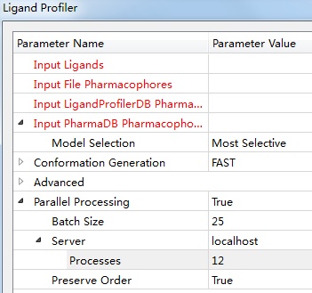

I use the ligand profiler to find the potential target by searching the PharmaDB, due to the long time it takes, I set the parrallel process to true in DS2020, but it seems that the protocol used only one processes (I use the command "top" to check in a linux terminal)to run even I set the process to 12, and how to set the batch size in the protocol? If I remember correctly, it is normal in DS2019?
It seems that the running time is not decreased?
So how to accelerate the PharmaDB searching if I have many ligands to search? How to set up the batch size and process in PharmaDB searching in DS2020?

when run in parallel, Ligand Profiler distributes your molecules across the available processes, so there is no gain, if you only run it on a single compound.
On more, it depends on how many compounds you want to profile and how many processes you can have. Running just one compound against the full PharmaDB takes some time, so setting the Batch Size as low as 1 is ok; this may not be optimal, however, for screening a large number of compounds or using only a small subset of the PharmaDB.
The maximum number of processes is obviously limited by your hardware, but also don't forget that in its default configuration the server allows a maximum of four processes per protocol. To use more, you need to adjust this setting on the Server Administration Portal.
