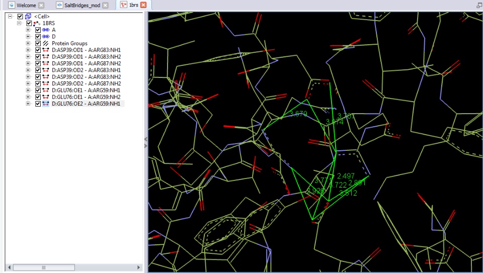

PURPOSE: Modified version of the script found under Scripts > Structure Editing > Find Salt Bridges. This version renames the generated monitors to reflect the names of the atoms involved in the Salt Bridge interaction.
USAGE: From the DS Client's Files Explorer, right-click on the file SaltBridges_mod.pl and select Open With | Script Window then launch the script using the Run command from the Scripting toolbar or the Context menu.
REQUIREMENTS: This script will run on the most recently viewed Molecule Window
