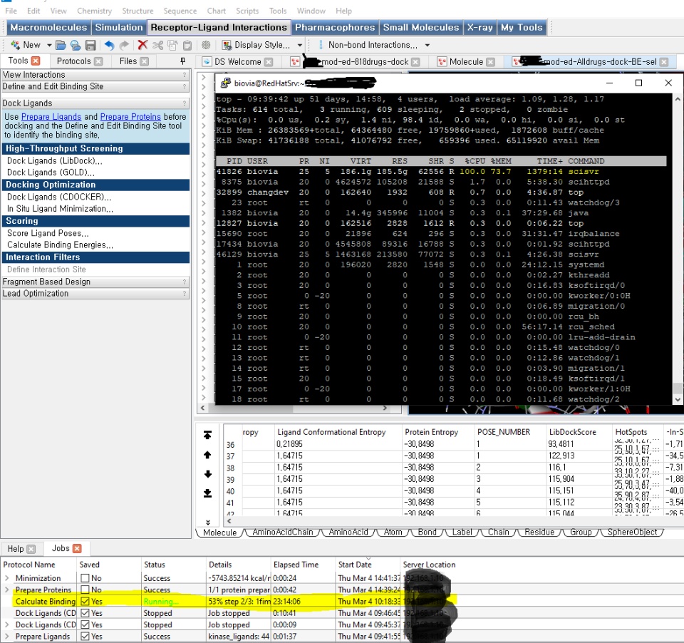

I am working on the VS of compounds against target of interest. First, I perform VS using libdock and then working on the BE calculations on the docked poses. However, I observed strange problem with DS 2020 as well as DS 2021.
for the BE calculation, following were my details. I have 800 poses of ligands.
in situ ligand minimization = True, Ligand conformational entropy=True, Implicit solvent model=Distance-dependent dielectric, Parallel processing=True, Batch size=25, Processess=32. In my server 32 cores available and wanted to use all to accelerate calculations.
However, when I monitor the job server connected by putty, the top command shows level of resourse used for this job.
step 1/3 in BE calculation is normal and used the max 32 CPU for calculations, however, when it come to 2/3 BE steps, calculations becomes super slower, for this step it tooks more than 24 hrs. When I checked with top command, it shows 2/3 step uses only 1 CPU instead 32 CPU.
So, here is my direct question that how can I optimize the DS for 2/3 step to use all 32 available CPU in my server?
I'm facing this problem since 3 months, and contacted with the local Korean vendor (Insilico Inc). They checked all the hardware and software multiple times, also we brought new windows PC station according to suggestions for DS2021, but nothing works out.
Please let me know the answer how to manipulate the 2/3 step in BE calculation to use maximum 32 CPU? I have attached with the snapshot taken to show the progress of step 2/3 and resource level usage at server.

Hi Changdev. Note that when a protocol is enabled for parallel processing, generally it does not mean that all parts of the protocol will be able to run in parallel mode.
Apparently, the ‘Calculate Ligand Conformational Entropy’ part of the Calculate Binding Energies protocol was not paralellized. That’s why we see the Step 2 of this protocol will only use 1 CPU.
We have logged this issue as DSC-33443 internally and our developers will look into the details.

Hi Changdev, I have run some tests using Discovery Studio 2021.
I have an 8 processor machine and I ran jobs using 100 ligands with in situ ligand minimization = False (in order to just focus on the conformational entropy calculation) , Ligand conformational entropy = True, Implicit solvent model=Distance-dependent dielectric.
1. Parallel processing=True, Batch size=1, Processes=8    Job runs for 4 min 41 seconds
2. Parallel processing=True, Batch size=12, Processes=8    Job runs for 3 min 30 seconds
3. Parallel processing=False    Job runs for 20 min 42 seconds
Therefore, I do see that the Conformational Entropy part of the calculation is running in parallel. In my tests, when I turn In situ Ligand Minimization to True, I do see that this part of the job runs a bit faster than the Entropy part (when running in parallel) but I think that is due to the fact that I'm generating many conformations and each conformation must be minimized in that step.
