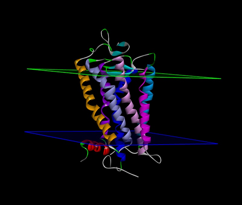

Color individual transmembrane helices unique colors
PURPOSE: Create groups and uniquely color each transmembrane helix in a GPCR molecule. If a membrane object already exists on the molecule, it is used to define the transmembrane helices. Otherwise, a membrane object is added.
USAGE: From the DS Client's Files Explorer, right-click on the file ColorGPCRHelices.pl and select Open With | Script Window then launch the script using the Run command from the Scripting toolbar or the Context menu.
REQUIREMENTS: This script will run on the most recently viewed Molecule Window which should contain one or more GPCR molecules
DISCLAIMER: This custom script is compatible with Discovery Studio 3.5. It is provided "as is" and is NOT supported by Accelrys nor is it warranted for any purpose whatsoever. The user assumes responsibility for any malfunctions or bugs.
