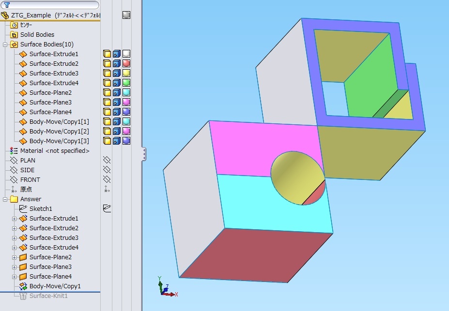

You can see a tangent hole to face and two cubes that have 1 common edge but "Solid Bodies" is 1.
And watch the highlighting face, it touches to another face , but it isn't blended.

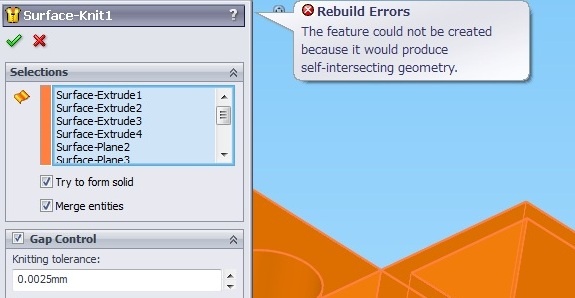

Then check the "Try to form solid" option.
If the option is grayout , it mean that you cannot create solid body.
In a case , you can knit them in 1 time.
In the other case , you have to knit them several times step by step.
Don't check the "Merge entities" option , it causes error.
That is obvious result because it merges surfaces that you created separately beforehand on purpose.
I suppose this option being fixed in ON by usual solid modeling method may be one of cause of the ZTG error.

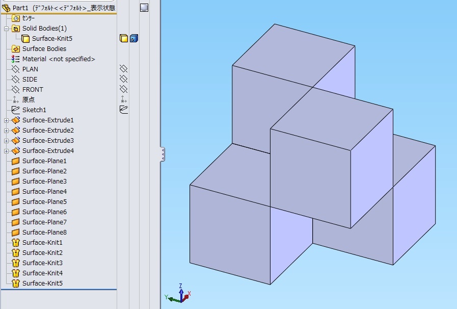

I tried to create various shapes.
Below is 4 cubes touching each other , but 1 solid body.
Below is exceptional example , it is a cube with tangent hole same as first example.
But strangely all faces are not separated.
In case of this , "Merge entities" option doesn't cause error.
I was surprised that I had this. I suppose this may be a miracle caused by tolerance of calculation?
