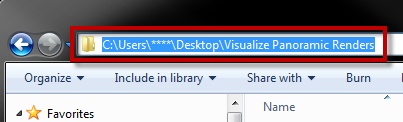

  8. Navigate to that new folder you created on your Desktop and copy the directory of that location from Windows Explorer (see image below)
  9. Go back to the Chrome settings window and paste this location, so shown in the image below:
  10. Then click "Confirm"

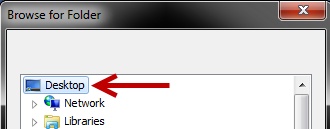

  8. Right-mouse click anywhere on the black screen and select 'Global Settings...'
  9. Click the 'Advanced' tab...and click the button 'Trusted Location Settings'
  10. Click 'Add' at the bottom...and then click 'Add Folder'
  11. Click 'Desktop' as shown in this image below...and click OK...then click 'Confirm'
  12. You will now see your Desktop location added to the Trusted File or Folder Location list. Click Close.
