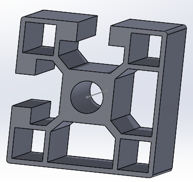

You can combine the steps I mentioned above with other sketch operations to configure sketch geometry in ways that you were never intended to be able to do. For example, by combining my discovery with a mirror operation I was able to merge and unmerge edges of my T-slot profile in different configurations of my profile. This way I can have all of my T-Slot profiles driven by one configurable weldement profile instead of 50 different files. To this effect I can change the profiles of my weldements and not have to redo mates if I’m working with them of the assembly level.

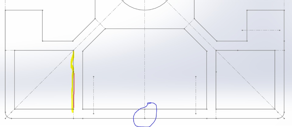

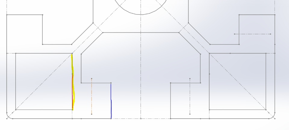

The "hiding spot line" is highlighted in yellow, the "parent line" is covered in red, and the "3rd line" and the "intended line" are overlapping, I marked them with blue. The dotted line in the middle is our extraneous "2nd line".
In the new configuration the "3rd line" disappears but the intended line remains (circled in blue). I also configured the "intended line" to change length and move to the axis of symetry that the lines are mirrored about. This causes the endpoints to merge and the profile to rebuild as intended.

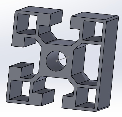

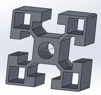

Each of these profiles uses a different configuration of my custom weldement profile. The faces merge without creating unwanted seams. The mates seem to be rebuilding as well.
