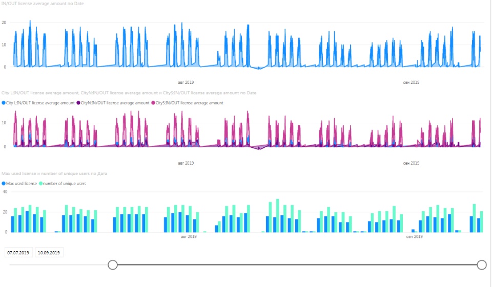

A few months ago, our company had a problem: lack of licenses. I’ve decided to analyze how long employees have been using the license. I’ve begun to read forums and search for information, then I’ve talked with colleagues at the SW-users meeting, also I found a video application here. As a result, I’ve decided to analyze it myself, have read the instructions of the SNL Manager and a log (lmgrd).
I’ve made the first version in Excel. I transferred data using copy/paste, but I’ve got the correct picture (see Pic. 1). Although it was an inconvenient tool, every time I needed to format new data.

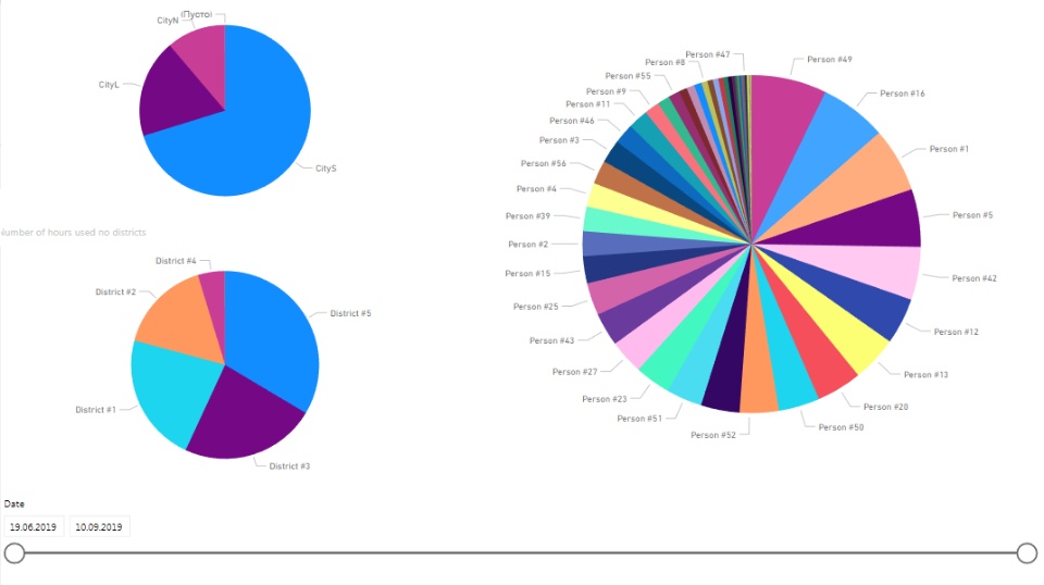

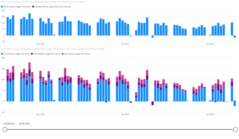

I’ve made the second version using Power BI, It is a very convenient tool for analyzing textual information, such as a log. Now I get online information about who uses licenses and how its use, how much time each department and each city use solid, what time is the busiest. The application opens in a browser; it reads information from the log file on the server and the list of personnel and departments. The application reads log information once a day. Of course, it is not yet universal, and in order to get new graphics, I need to make changes to the code.
As a result, this application allowed us to reduce and distribute the load. Previously, we lacked 18 licenses, and at peak times we received refusals, now at the peak moment we use no more than 15 licenses, since we distributed the time of use.

Picture 1. Graph using license IN/OUT 3 month Version 1. Excel
Picture 2. Graph using license IN/OUT 3 month Version 2.
Picture3. Graph using license IN/OUT per day

Picture5. Diagram time using license by Cities and Departments
