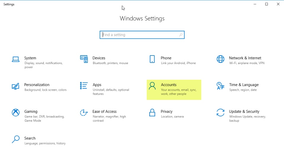

Press Windows+i to open Windows Settings
Then select Accounts

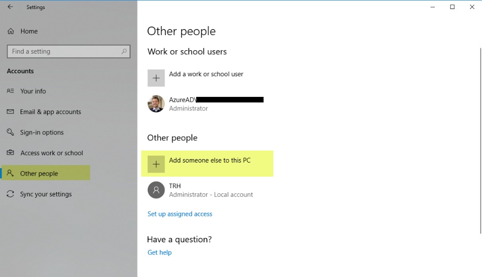

Select 'Other People' and 'Add someone else to this PC'

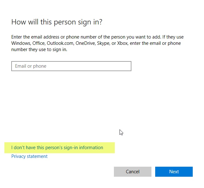

The Microsoft account window opens and here you select 'I don't have this person's sign-in information'

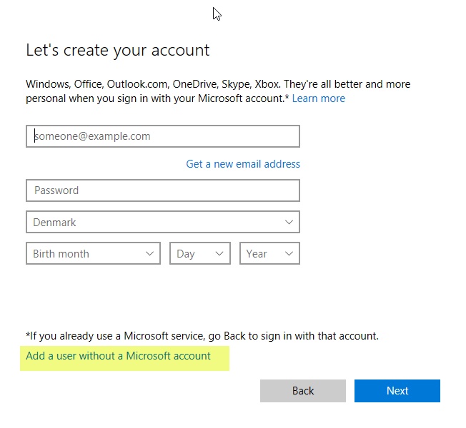

Microsoft still try to convince you to use a Windows Account, but select the 'Add a user without a Microsoft Account'
The rest is straight forward, so not documented here.

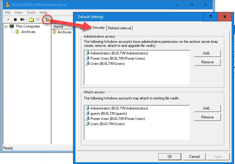

Now, when adding the vault views or adding the server to the Administration it all works.
Create the views with the local account and then simply logg off and log back in with your Azure account - the views are there and you have access to the PDM Administration.
If someone knows how to add the Azure account to the local group on the PDM Archive server please let me know here and this workaround becomes 'obsolete'
