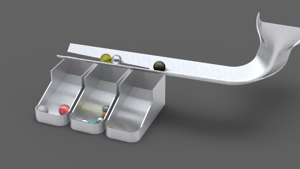

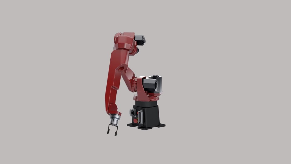

I have been playing around with this capability and would like you to take a look at the attached videos, its focused more on functionality than an amazing looking render but it shows one of the biggest bonus' of using the motion study import option, WE CAN IMPORT GRAVITY!
this may be old news to some of you or you may have figured it out on your own but from my trials of the new functionality I have noticed that you can import any motion study that does not include the manipulation of actual geometry (so no windy flag animations unfortunately) this includes gravity studies, parts being controlled by motors and motion studies put together with the Mate controller option in SolidWorks for advanced motion.
