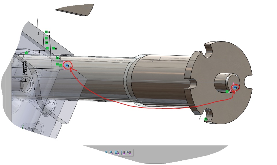

I have two lines in 2 different revolve sketches that I want to be equal length.
These two lines are NOT on parallel planes.  The planes are 35 degrees from each other.  I thought that it was impossible to make lines equal length if they were not on parallel planes.  However, when I selected it, I wasn't even thinking about that and it worked!

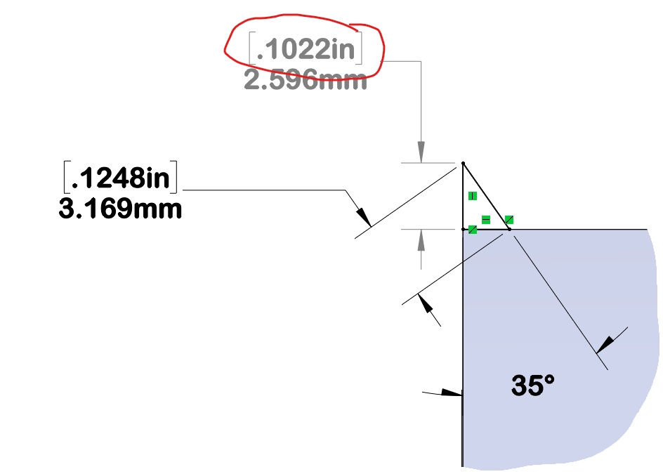

Here are the two lines:
The length of the line on the right is 0.12475" long (creating a diameter of 0.2495" once revolved).
The line that I matched it to after "Make Equal" has been applied, is 0.1022" long.  Which the projected length of the first line, when you project it onto a plane at 35 degrees. Example:
So, when I asked it to "make equal" it not only let me do it, but then proceeded to make the line the incorrect length and instead made it the projected length.

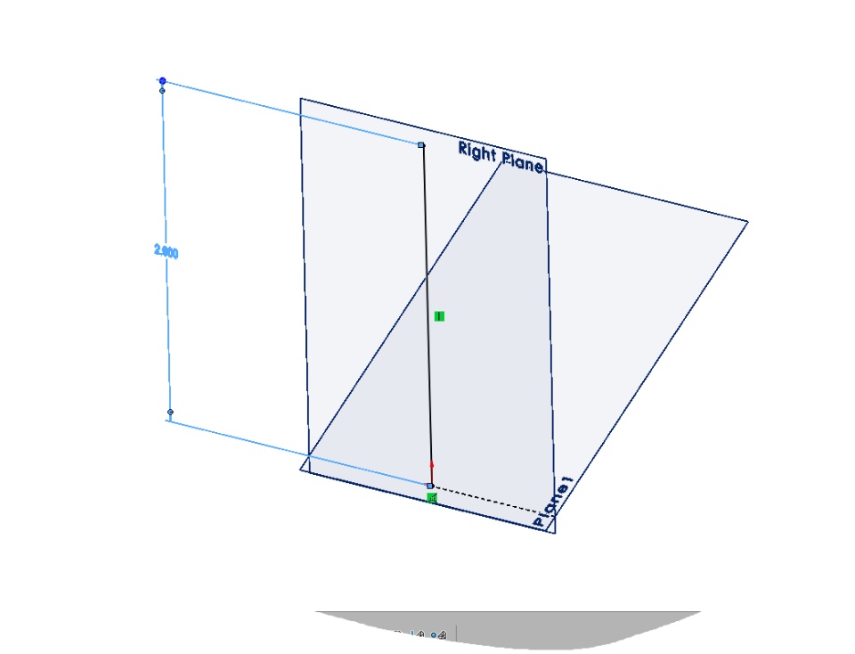

Here is a test:
The 2 planes are 45 degrees to each other.  The 1st line drawn is 2" long.

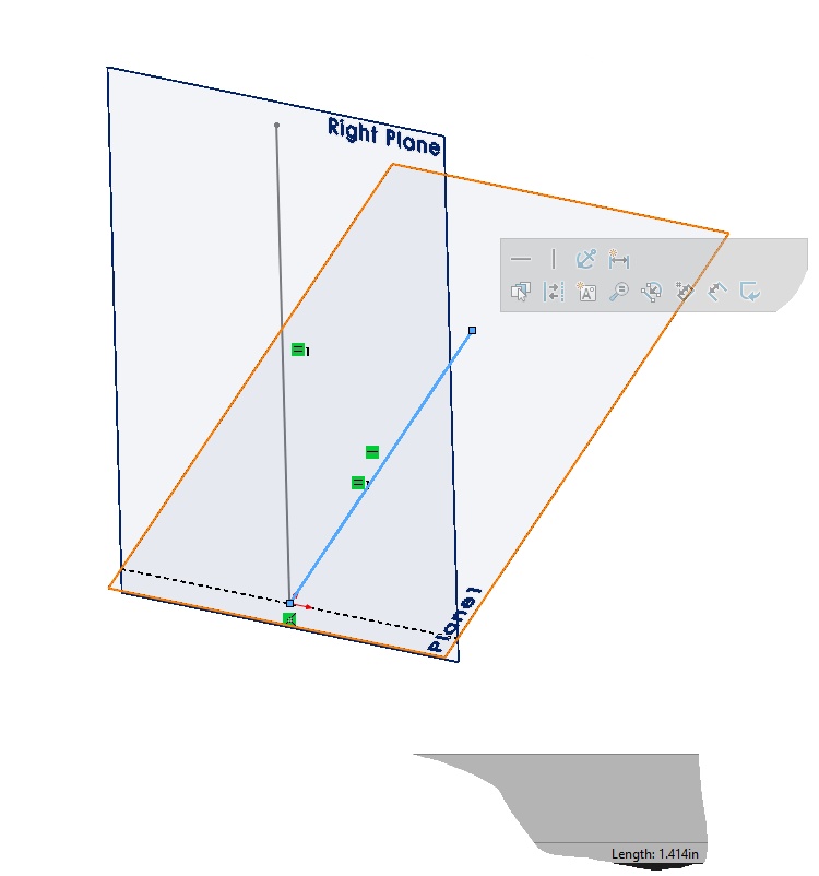

Drawing a line on the angled plane and making it "equal length", makes the line 1.414" long:

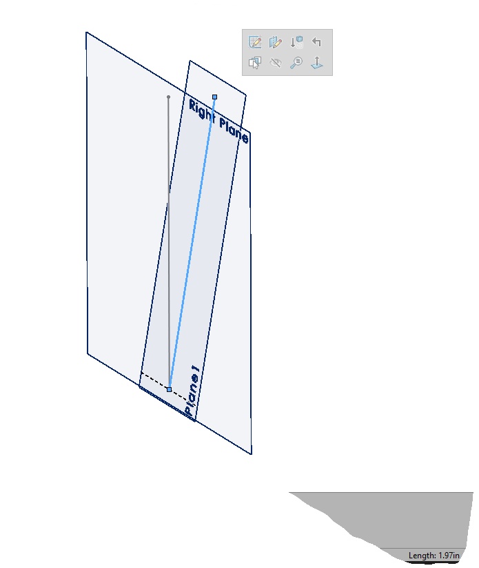

Simply changing the angle of the angled plane to 10 degrees changes the length of the line to 1.97":
