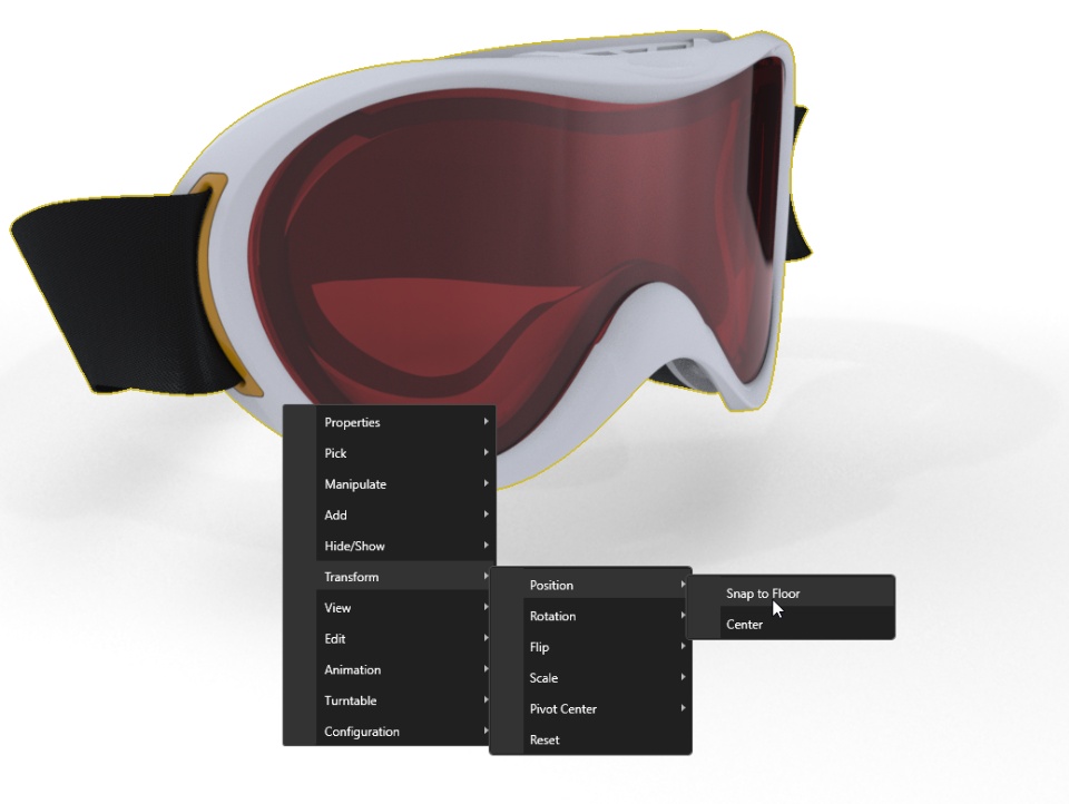

Some examples of small things making a big difference. It seems like the right click menu can give you easy access to just about any option and they are all sensibly catagorised, great for seldom used commands. e.g. snap to floor below

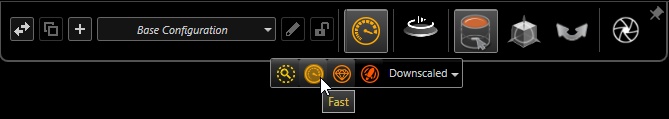

Fast Mode- Speed and Quality
Yes! the amount of times i have to go into options in 2017 even in demos to switch between these modes, speed mode is also excellent when combined with presentation mode (when there aren't lots of transparent objects) for live rendered presentations

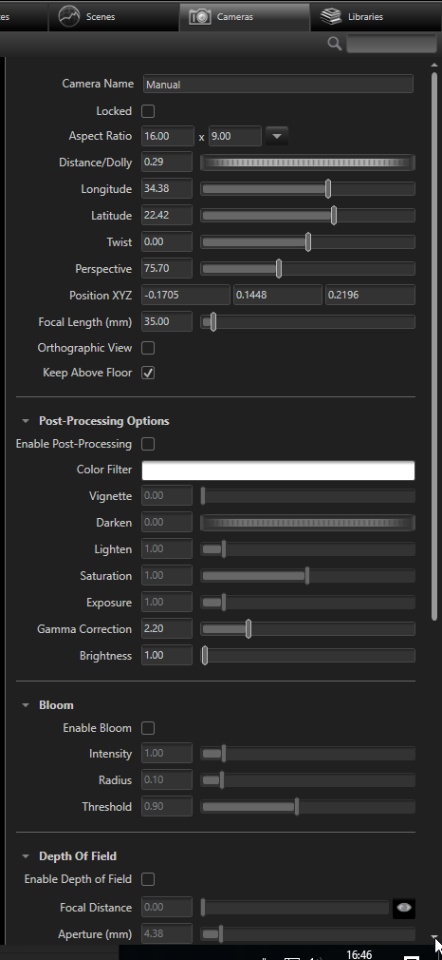

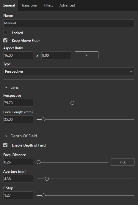

Categorization- Splitting up settings into sensible tabs, best example for me is the camera tab, really well devided feature sets where as before there was alot of scrolling and expanding menus
2018                                                                                                                           2017

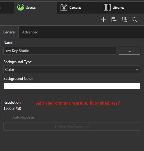

Consider more options on the Scenes -> Basic Tab
It's a little too basic for my liking at the moment, i don't feel it is advanced to want to rotate the lighting, turn floor shadows on/off perhaps even adjust the brightness, so perhaps we could duplicate those settings here as there is plenty of space

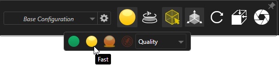

Render Modes
i'm in two minds here, the old icons did look a little dated and perhaps i'm just seeing this because it is quite a change but i'm not sure that the new symbols for Preview, Fast and Accurate have enough contrast/ communicate enough about the different render modes for me. However they are much cleaner and easy to pick up on.
2017
2018

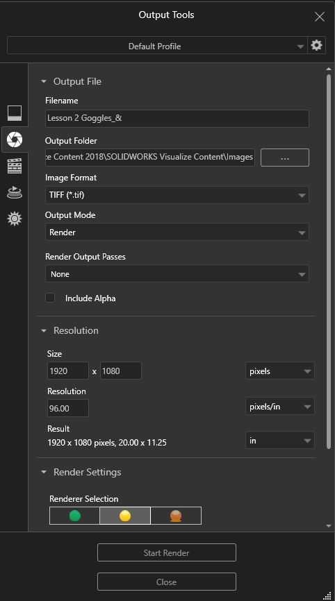

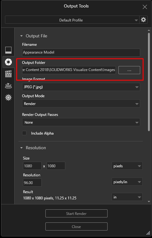

Allow expansion of the Output dialog width wise, + automatically include the render settings (i had to drag to make the dialog longer or scroll to see render mode etc)
