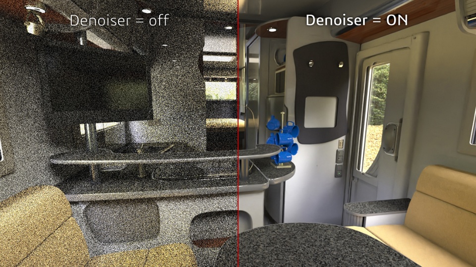

As you've hopefully heard by now, we're about to release new integrated technology to make your Visualize renders finish 10x faster! It's called the AI Denoiser, which uses machine learning and artificial intelligence to anticipate and magically eliminate noise in your scene. What does this mean? You can expect the same photo-quality results 10x faster!!
This could be a still image, animation, 360 spin, new immersive 360-VR content or any render job from Visualize. Not only does it help your final renders finish 10x faster, you can also enjoy this dramatic speed-up while preparing your Visualize scenes as well. I’ve been testing the Denoiser the last couple months and it’s blown me away.
