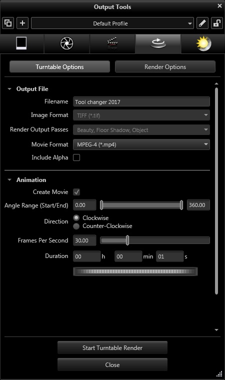

PS: I had a hunch that it would be a bad idea to have "create movie" be enabled by default. And it turned out I would be right to be concerned. It cannot be disabled if there are render passes enabled. And you can't disable the render passes if create movie is enabled. Paradoxical...
The reason the render passes are ticked is because those were my output settings for the last session. Create movie was not ticked then. But because Visualize assumes that everyone wants that option enabled it goes ahead and ticks it for us no matter what it was set to the last session.
I never, ever want to have that option enabled. I assemble all of my frames in After Effects, along with their render passes.
