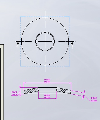

Hello. I am trying to automatically set section line endpoints to be at the edge of your parent drawing view when changing configurations. For example, when I change the configuration of this drawing I still want the section line on the outside of the part so it is not cutting off the section view. Because this is a part of a automatic macro, I don't want to have to manually change the section line every time the program changes the part configuration.
