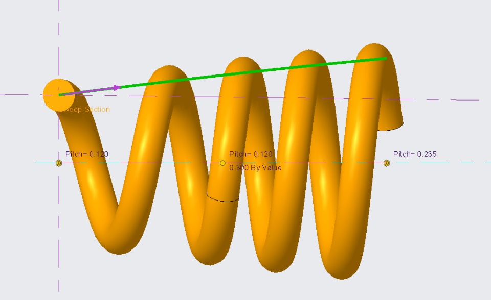

In Creo I simply create a sketch on a plane generate the variable pitch helix about a CL that follows a curve.

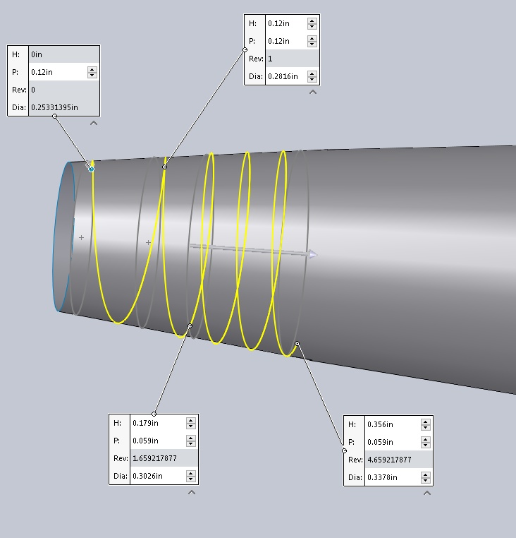

In SolidWorks it seems I can not select a guide curve to follow and the Helix command is limited to entering a Dia. at each height.  I added some pics to show what I'd like to do.
Pic:1 "solidworks helix"  the grey area is the contour I need to follow and the yellow helix in the center of the coil.
Pic:2 "CREO helix with guide curve" show the sketch of the helix and it's constraints.  The green line is the contour (guide curve) that the helix follows.
Pic:3 "CREO complete helix" is the final outcome.  disregard the dual helix pic 2 only shows the first wrap.
