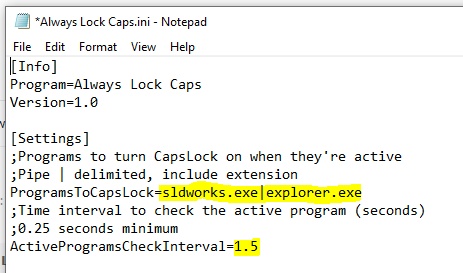

Setup Always Lock Caps:
Double click "Always Lock Caps.ini" and it will open in Notepad (or your default text editor).
More than one program can be specified as a program that is Always Lock Caps.
The exe file name for each desired program must be specified after "ProgramsToCapsLock=" with each exe name separated by a pipe |, below SolidWorks and Windows Explorer will get CapsLock turned on whenever they be come active.
Checking for the active programs is on a timer and how often this check is made is set by the value (seconds) after "ActiveProgramsCheckInterval=". A second and a half is the default, 1/4 of a second is the minimum.

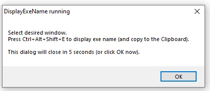

Easily determine a program's exe file name:
Run "DisplayExeName.exe" to easily extract the exe file name from a running program.
As stated on its intro dialog, make the desired program active and press Ctrl+Alt+Shift+E and that program's exe file name will be put into the Windows Clipboard for pasting directly into "Always Lock Caps.ini".
You can right click the tray icon for "DisplayExeName.exe" and select Exit when done selecting programs as this utility is only used for this purpose.

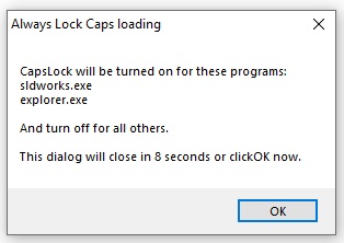

Running "Always Lock Caps.exe":
When loaded, an intro dialog displays showing the selected exe file names (which are duplicated in the About dialog):
