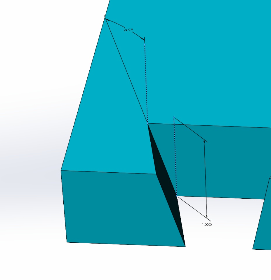

  1. Create a plane that's mid plane to 1st Adjacent Face and 2nd Adjacent Face.
  2. Create 2 lines on that plane; 1 that starts at the Seam Top Vertex and the other at the Seam Bottom Vertex, make them parallel, and dimension them to the line(called seam above) using the value in the Tool Tip Angle field. The dimension should be acute towards the side above Top Seam Vertex. (see photo below)

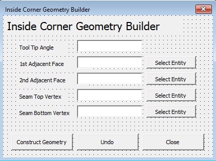

Below is a form I have created to help me select and identify the entities. The desired result would be to have the buttons labeled 'Select Entity' populate the fields with the entity name but I also need to store the object for building off of later. So, my question here would be:
 - How should I handle the storing of this object on the click of  the 'Select Entity' button and access it's properties for use in other subs?
