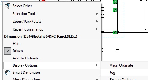

The "9|1" example is for toggling jog ordinate. "Display Options" is 9th (starting at 1) and "Jog" is the #1 position (starting at 0):

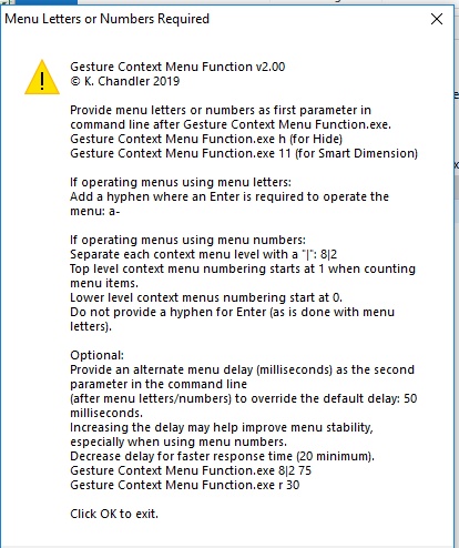

Help dialog:
Run the utility without any command line parameters to display this (somewhat) helpful dialog:

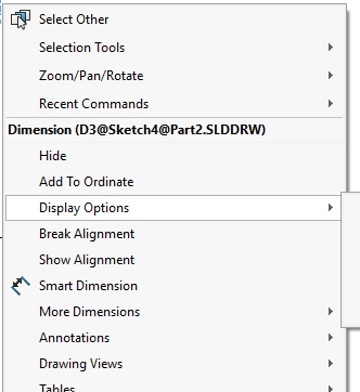

Of late, for reasons unknown to me, the "d" for the "Display Options" context menu no longer responds to the "d" sent to it, rendering the current rendition of this utility useless for making these dimension changes (jog, add to ordinate, center, reference). Even odder, is that I have another utility where the jog ("d-j") does work, but the other "d" menus don't.

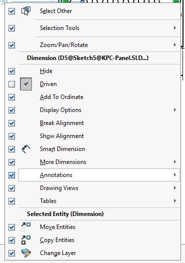

BTW, to see which letters are underlined in a context menu, select "Customize menu":

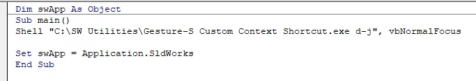

  3. This is the macro that runs the JO gesture above.
    When you start a new macro, 3 of these 4 lines are inserted for you. The "Shell" line you add.
    But, here it is so you can just copy it:
    Shell "C:\\SW Utilities\\Gesture-S Custom Context Shortcut.exe d-j", vbNormalFocus
  4. For your macro, you'll need to change the path if your folder is different. Be sure to quote it as shown.
    Keep the menu letters, "d-j" that are within the quotes. I cover menu letters in a minute.
  5. That's the end of the programming part. Save the macro.

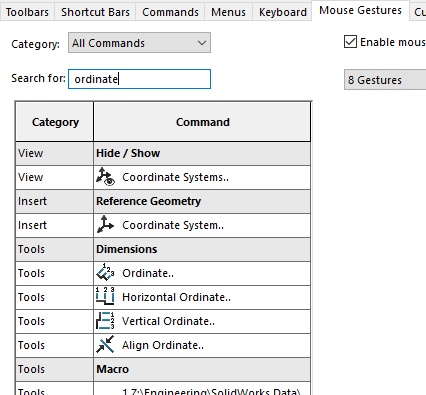

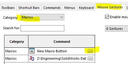

  6. Add the macro as a gesture (this is standard SW gesture customization).

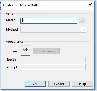

    Select Macros as the category and then click the dotted button:
  7. This dialog displays. Navigate to the macro you just saved.
    Optionally: add an icon and a tooltip.

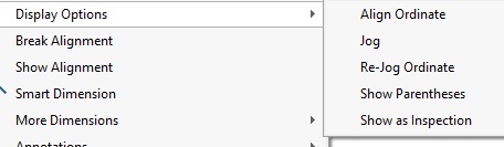

So, typing a "D" would select "Display Options". This menu isn't underlined, but the "D" selects it. It's not always the first letter, so select each in succession (for "Edit text" for a note, it's "I"). Case doesn't matter for this.
But for this menu example, there's another "D" menu: "Drawing Views".
When this happens, the menu is highlighted, but not selected. Each press of the "D" (in this example) cycles through all menus with the same menu letter.
When you've selected the menu you want in this situation, you press Enter to select it. (This is all standard Windows menu behavior.)
When you need to press an Enter to operate a context menu selection, type a hyphen "-" in the menu letters of your macro.
So, "d-" picks the first "D" menu and the "j" selects the "Jog" submenu:

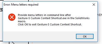

PSS: If you omit the menu letters in the macro, you'll see this dialog:
After OK, nothing happens. Edit your macro and add the required menu letters.
