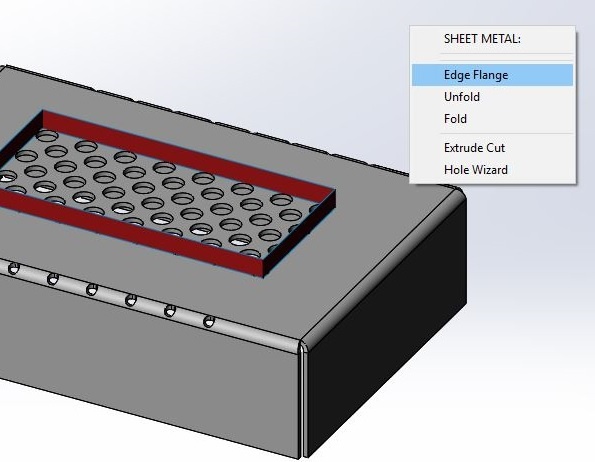

This is an example of a sheet metal Gesture Xtender:
"SHEET METAL:" is an optional heading (that doesn't do anything). The separating lines are also optional.

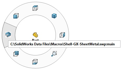

This Xtender gets displayed when I select the 6 o'clock part gesture wedge (I didn't add an image to wheel for this, but you can):

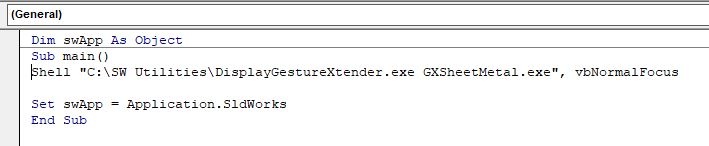

Each Xtender runs a macro to display the Xtender menu:
"DisplayGestureXtender.exe" takes an Xtender name, our sheet metal example "GXSheetMetal.exe", passed to it on the command line and sends a message to this Xtender, telling it to display itself.
Once displayed, selecting an Xtender item runs the SW command that you assigned it to run.

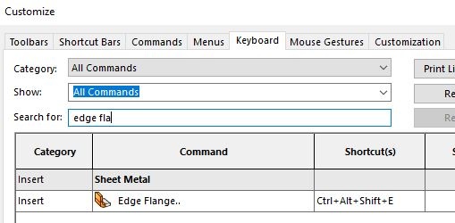

The text right of the pipe "|" is the code referring to the SW keyboard shortcut you assigned to that function.
Since you're not physically pressing these keys, you assign the "harder" key presses to Xtenders.
Saving the easier reaches for the shortcuts you actually press. Keyboard shortcuts you do actually press can also be added to an Xtender.
You can use any combination of Ctrl, Alt and Shift (or none) with A-Z (case doesn't matter) and 0-9 (this where the 288 comes from).
For the ini file, you must convert Ctrl to "^", Alt to "!" and Shift to "+".
So SW's "Ctrl+Alt+Shift+E" becomes "^!+e" in the Xtender ini file.

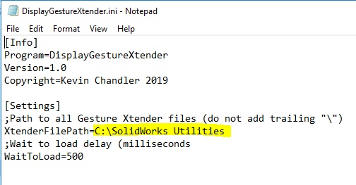

- Edit DisplayGestureXtender.ini (it opens in Notepad) and modify the XtenderFilePath data to match your folder's path:

- Create a new SW macro:
- All of the lines, except the "Shell" line, shown above are created in a new macro.
- Add the Shell line, editing the path according to your folder.
You can also copy an existing macro and edit it, but to avoid confusion, be sure to edit the project properties and module name in the copied macro to match the new macro file name.
- Assign the SW macro to a gesture.
