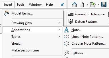

As a reminder, for menus that share the same underlined letter, like the Insert submenus: Annotations and Tables, an Enter is required to execute the currently highlighted selection. To specify an Enter in the menu's syntax, use a hyphen.

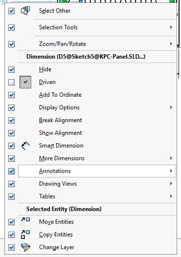

BTW, to see which letters are underlined in a context menu, select "Customize menu":
Updated 03/01/2019: Version v1.02. Added the ability to run pulldown menus in addition to context menus.
To operate a pulldown menu instead of a context menu, begin your menu letters with an exclamation point "!". Then select the letters that generate the desired function (as usual).
Most of the pulldown menu items are already available as keyboard shortcuts (built-in or user created) and for mouse gestures, but this new functionality allows you to add to your custom menu instead.
The ini file format didn't change for v1.02 so you don't need to rebuild the menus from your current ini into the new ini file to use the latest exe. Just add an ! menu line.
For example, the last line in the attached "SW Drawing Menus.ini" opens the properties dialog:
I chose the same underline letter as in SW's menu, but as usual, this isn't a requirement.
Unlike a context menu, where the cursor is when you press your menu hotkey, most likely won't matter with pulldown menu items.

Updated 02/20/2019: No program changes. SW view context menus behave differently than other context menus within SW.
1) The view menu doesn't respond to keyboard navigation (Enter and Up/Down).
2) Not all of the menu items have an underlined character, but:
2a) The ones that don't have underlined letters, don't respond to any of the letters in their name, such as "Alignment".
2b) Some items with underlined letters, such as "Recent Commands" and "More Dimensions" don't respond to their letter.
This I consider defective operation.
Although the view menu won't respond to this utility, you can still display it by specifying nothing after the delimiter (as shown above).
BTW: The reference dimension secret sauce, "d-s", is the same for ordinate and regular dimensions, so this one menu is good for all dims.

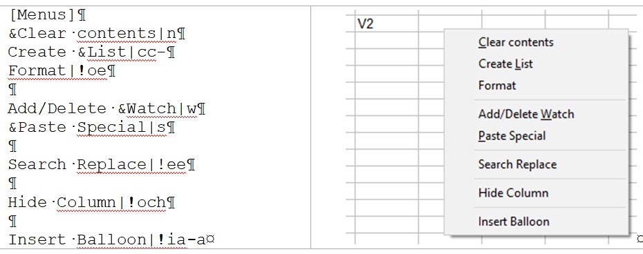

Also, I figured out how to capture the custom menu using Snipping tool. Above is an Excel custom menu and its ini menu lines.
Note the double separator made from two blank lines. Also, the caret is at the end of the last line. Blank lines beyond this will create separators at the bottom of your menu.
In Excel, Copy and Create List are both "c". Since Create List is the second one, there are two c's followed by the hyphen (for Enter).
In Excel, "n" is the underlined letter for "Clear contents", but in my menu, I preferred "C".
In your menus, you pick the content, each menu item's text, the menu order and organization, and optionally, which character for each menu item gets an underline.
All of the above items have an underlined character, but this isn't a requirement. Add them when and where you think it's best.
If you want to add an ampersand to your menu text as a literal "&", type &&. If you do this, you can still use a single "&" elsewhere to underline a character.
