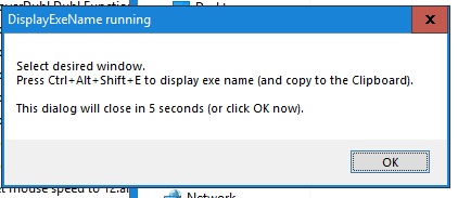

Since this isn't always readily apparent, in the V2 zip file is "DisplayExeName.exe".
Run this and this intro dialog displays:
As it says, make the desired program active and press Ctrl+Alt+Shift+E.
The EXE name is displayed and also stored in the Clipboard:

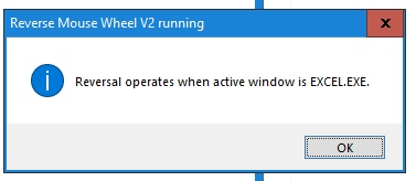

Start "Reverse Mouse Wheel V2.exe" and you'll see an intro dialog with the EXE name the reversal works on:
If this isn't the desired program, repeat the above (or edit the text file directly).

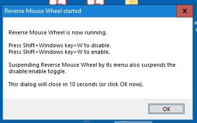

Same as original "Reverse Mouse Wheel.exe" except I added an enable/disable toggle by pressing Shift+Windows key+W.
An intro dialog is displayed on startup:

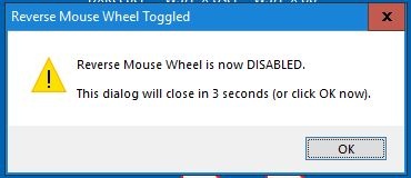

Utility starts enabled, so the first press of Shift+Windows key+W disables the reversal and this dialog informs you:

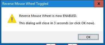

This key combination is a toggle, so press again to enable:
