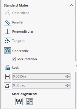

I have a model with two parts and two mates. A simple pin with a shoulder in a hole:

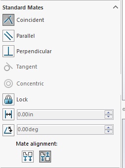

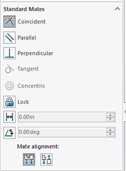

The model has two configurations. The coincident mate has a different mate alignment in each configuration, which I am pretty sure is supposed to be impossible:

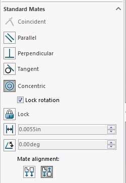

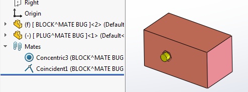

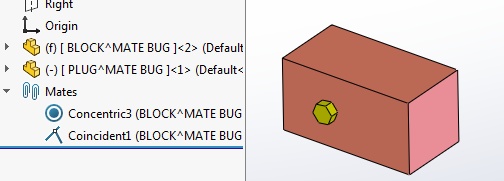

When I switch configurations, the model dutifully responds.
The alignment of the concentric mate is the same in both configurations:
