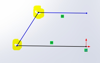

How to detach lines that are connected with end points? There is no relationship like in Solid Edge that you can delete.

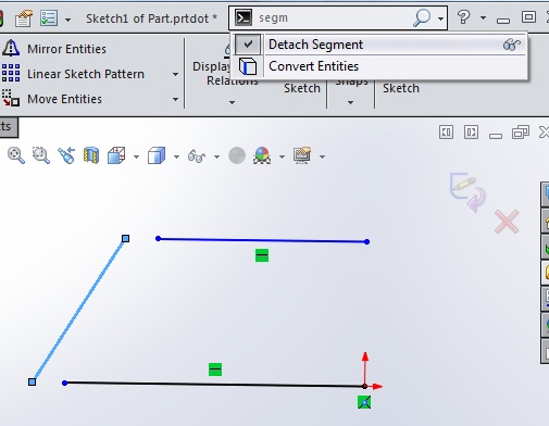

It can be achieved in 2 ways actually. In Tools-Sketch Settings are options
*) No Solve Move
*) Detach Segment
Both can be accessed from command search too

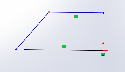

that both allow dragging one line away without solving another. You cannot drag it from endpoint, you have to move the whole line.
Then reattach the other end.
Considering possible alternatives I find those several actions good balance with keeping the design intent.
