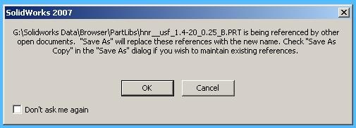

When saving most of our large assemblies I get thepromptshown below. SW has not used the *.prt extensionforquite some time, but those parts are still used in many of ouroldsub-assemblies. None of our files are used forcustomerpurposes, only in-house projects, so this is more or lessanuisance since we don't use BOM's for nuts/bolts (althoughweshould). As many as 25 or more of these prompts come up,onefor each referenced component, each time the file is saved,whichreally slows down progress. Checking "don't as meagain"is only a temporary fix. And then theres theissue with the*.prt files opening with the wrong configuration, ifat all.
How can I changed the old *.prt hardware components tothemost recent toolbox?
I checked our network drives and found a total of eleven,yeseleven, toolbox locations. About half of them are theold*.prt hardware files (...\\partlib\\) and the other half arethe"newer"...\\browser\\. Tools>Options>HoleWizard/Toolbox is onlyreferencingthree of these, so the rest are not causing anyproblems. Most of these locations are copies and old browsersfromprevious SW installs. I'd love to delete all theoldbrowsers, but I have no good way of knowing if they arebeingreferenced anywhere.SolidworksToolbox
