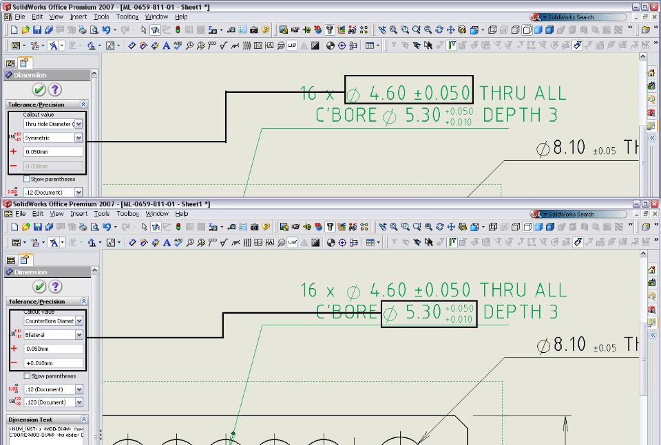

I am trying to add tolerances to a counter bore hole callout. The hole was created as a legacy hole. When I addthehole call out I get both the through hole and counterborediameters, but I am only allowed to add tolerances to thecounterbore diameter.
Is there a way to toggle between the diameter values?
