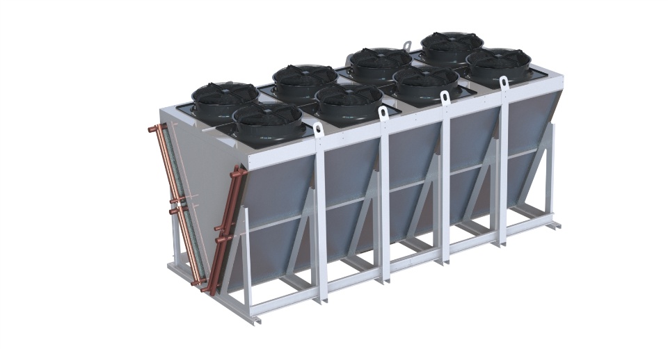

An example is an air cooled condenser, how long did it take for this project? How much time is spent on assembly, how much on drawings?
Let's take a look at the numbers.

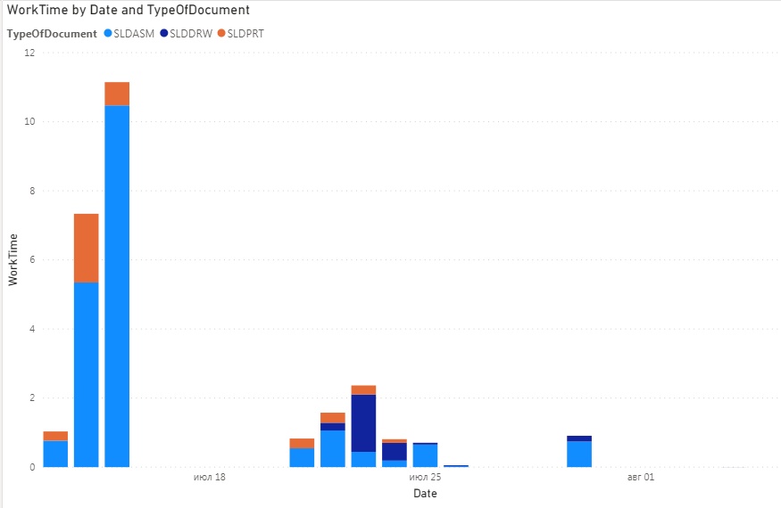

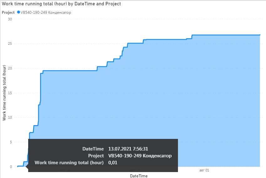

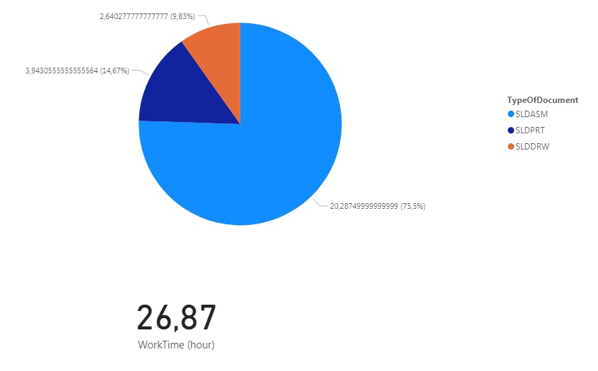

The total time of work is 27 hours, most of the time was spent on work in the assembly 20 hours, 10% of the time was spent on drawings.
The main work began on 13.07 and ended on 06.08, the time interval is 31 days.
At the same time, they worked on the project in SOLIDWORKS for 12 days, of which only 9 with a time spent more than 1 hour. I went over to the drawings on 22.07 and worked on them for 4 working days.

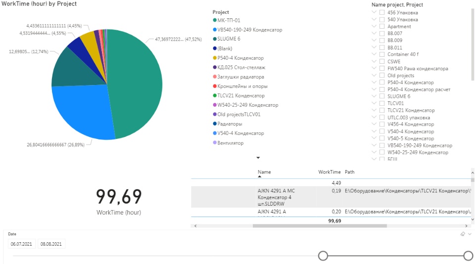

What if there are several projects?
The total working time in SOLIDWORKS is 100 hours from 06/07 to 08/08, work on our project took 27% of the total time.

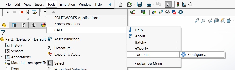

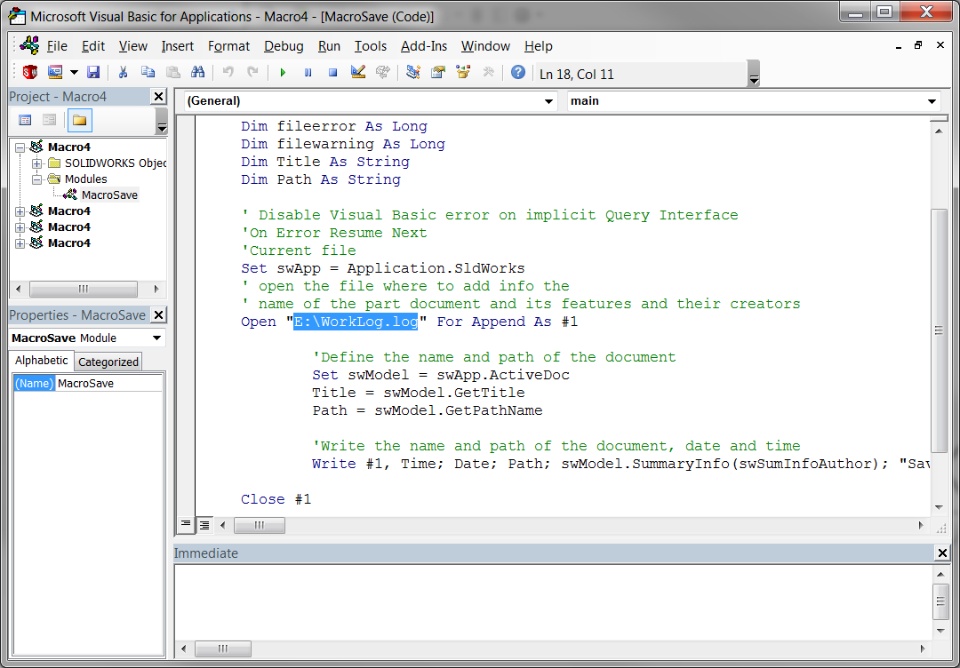

To install and use logging macros, I used add-inCAD + Toolset, it is free (registration is required to obtain a license), you can download it from the link https://cadplus.xarial.com/ where you can also find installation instructions.

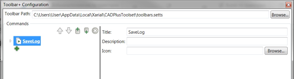

The CAD + tab appears in the toolbar (Tools)
Next, select Toolbar + / Configure and create via + the SaveLog macro block, the block should be the only one (so far).
It's just a section with a common name that summarizes individual macros.

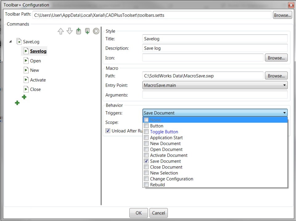

In the SaveLog section, press + and set each macro in turn:
Title: Macro name (the name corresponds to the action of the macro)
Description: Description (optional)
Path: The path to the location of the macro.
Entrypoint: The macro is simple, the entry point is the only one
In the Triggers tab, select the required action at which the macro will be triggered.
A total of 5 macros need to be installed. Each macro corresponds to a specific action.
MacroSave.swp – Save Document
MacroOpen.swp– Open Document
MacroNew.swp– New Document
MacroActivate.swp– Activate Document
MacroClose.swp– Close Document
Unload After Run – leave a check mark.
Create each action one by one. As a result, we have 5 automatic actions in the SaveLog group.
Pass to each macro in turn and write a document to save for each user.
All macros have one common document where all actions are saved. The user must be registered in SOLIDWORKS documents, otherwise there will be no division by executor. Or, for each performer, you need to create your own macros with a separate document (log) for each user.
Macros are seamlessly and automatically logging information, you can check in the file WorkLog.log

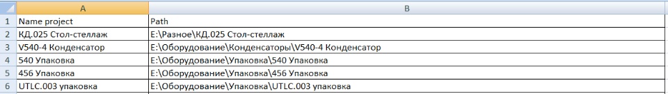

For further processing of the log, it is necessary to fill in the Project List.xls, the table assigns a path to a specific order.
Analytics will take place based on this table.

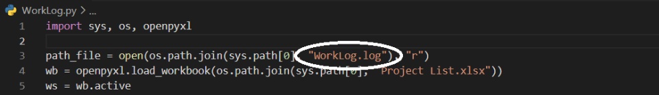

You need to install Python (download from here https://www.python.org/downloads/). It requires the pandas, nampy, openpyxl libraries, how to install can be found on the Internet.
Copy the WorkLog.py file into the directory with the log file and run it, then specify the file with the full path to it.
The program processes the log and creates a new document with the assigned project names WorkLogResult.txt.
Next, install POWER Bi - this is a utility from Microsoft (how to install can be found on the Internet https://powerbi.microsoft.com/ru-ru/desktop/).

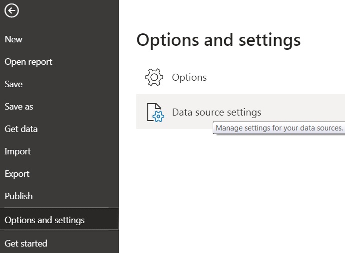

After installation, open the WorkLog.pbix file
In the document, click the file, select the options and settings
Data source settings
We replace the proposed sources with our own files (Project List.xls and WorkLogResult.txt)
Now you can analyze the received data.
