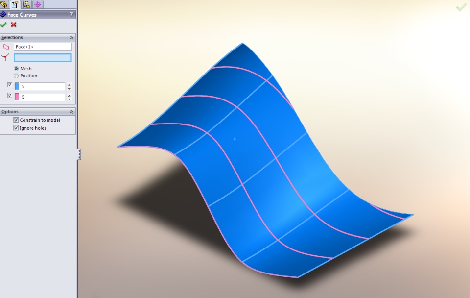

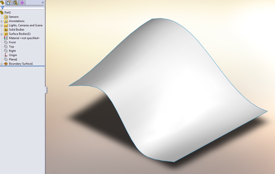

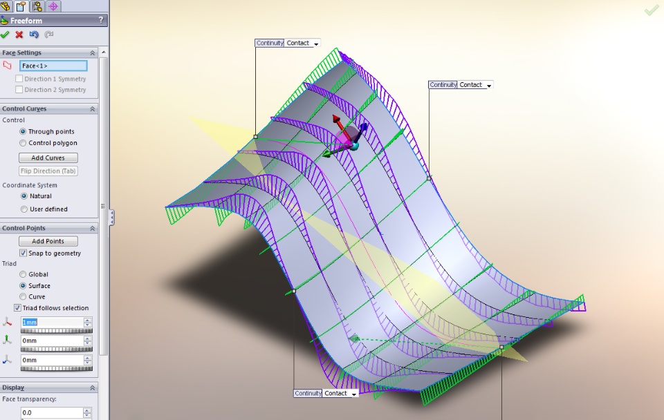

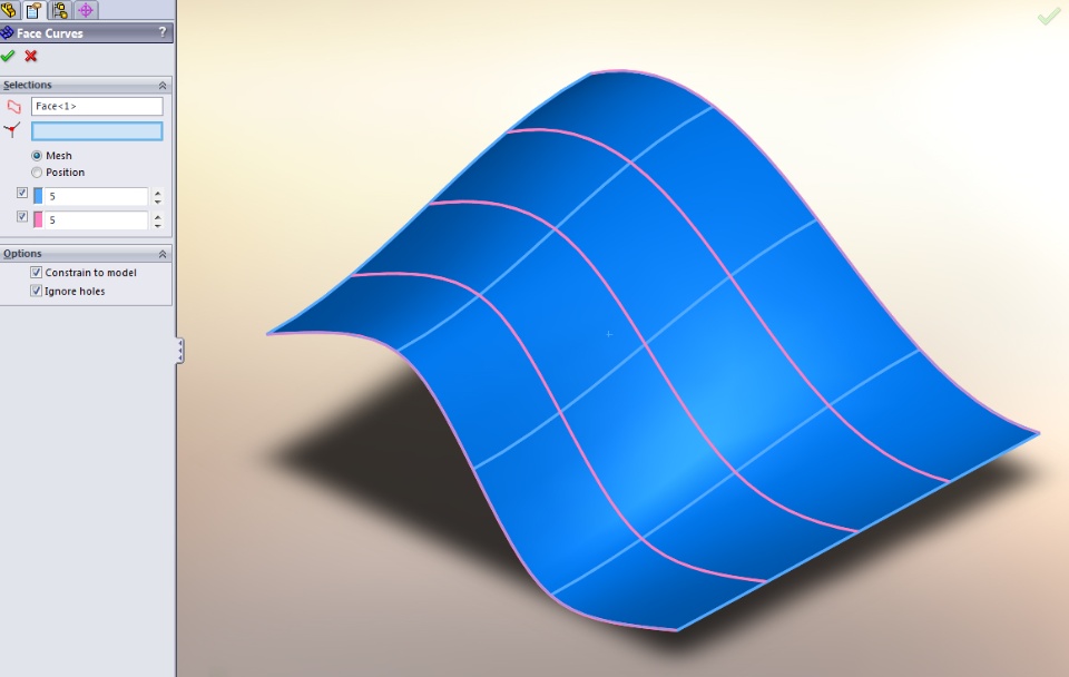

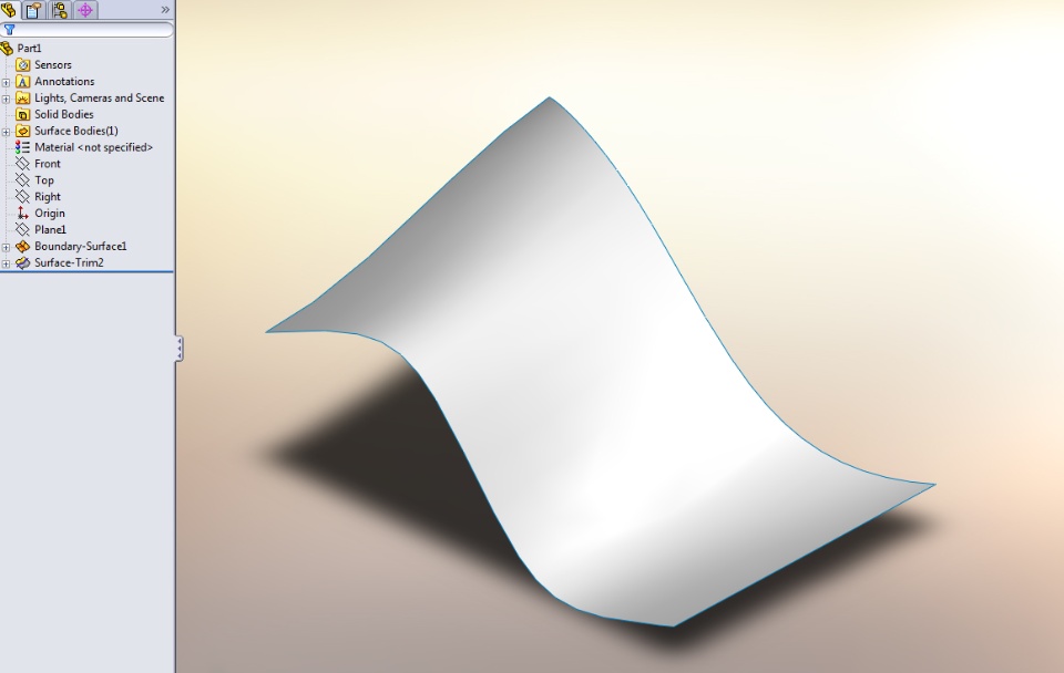

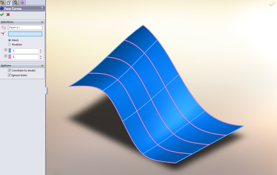

I have found Freeform can be used as a hack to trim-convert a patch. My method is not perfect as I am forced to change the surface slightly (I just made an interim curve in the Freeform PropertyManager) so let's see if we can improve it!
