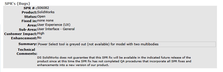

I have been looking into Power Select because I was looking into ways to help this person with this thread:
2017 SOLIDWORKS Help - Power Select
I am using SW 2017 SP5.
When I couldn't access it, I remembered that there were other times that I couldn't access it
It seems that in order to actually use it, you have to have all the planets aligned.
Must have "Solidworks Utilities" turned on under Tools--> Add ins
I did some experimentation and found this criteria.
| # Solid Bodies | # Surface Bodies | Power Select Available? |
| 1 | 0 | Yes |
| 2 | 0 | No |
| 1 | 1 | Yes |
| 1 | 2 | Yes |
| 2 | 1 | Yes |
| 2 | 2 | No |
| 0 | 2 | No |
| 0 | 3 | Yes |
| 1 | 3 | Yes |
| 2 | 3 | Yes |
Ok, this must be something screwed up in the programming....maybe?
Found this:
Comments?
