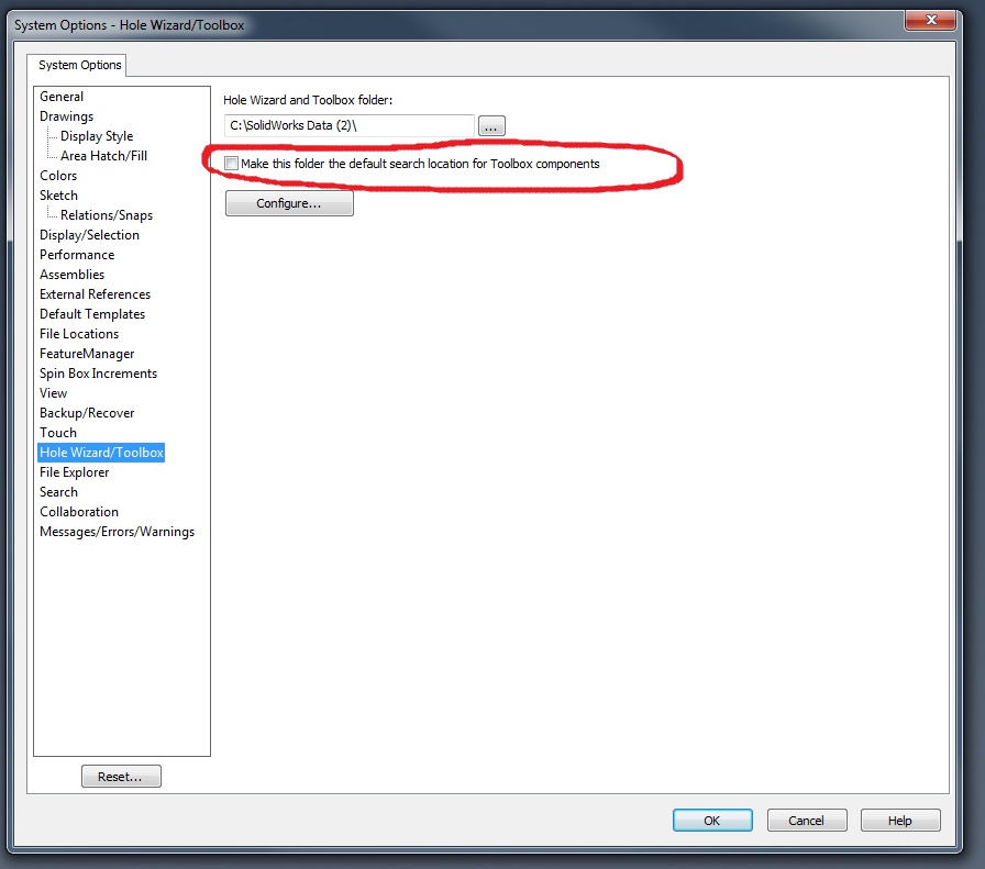

Don't forget to un-check this box (it will be checked by default) if you have saved toolbox parts to a different location.
