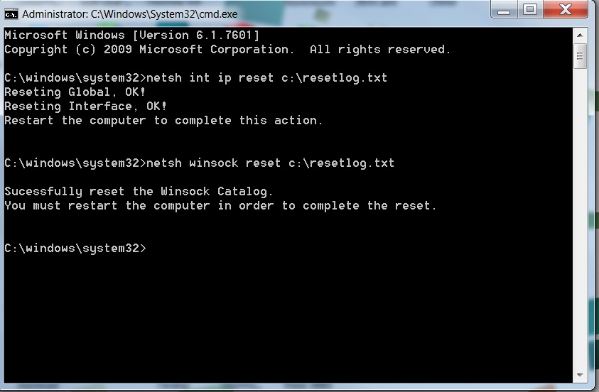

My problems (all of these started in the last few weeks -- everything was OK before that):
  • SW2013 could no longer use Web help ("network not available")
  • SW2013 could access Customer Portal (Firefox starts) & User Groups (IE10 starts), but NOT Discussion Forums ("network not available"). However I could use my browser to access these forums.
  • SW2014 installed OK but I could not do Network Acitivation ("network not available")
  • I did email activation of SW2014 and saw the succesfully activated products screen, but then SW2014 stopped. When I retsarted SW2014, I had to do email activation all over again, then SW2014 stopped.
  • I could no longer access my networked printers, but I could see them on the Wndows 7 network map. Reinstalling via TCP/IP address failed. ("no device at this address")
  • WIndows Update stopped working, and I could not manually start the windows update Service.
I tried all the usual things: firewall settings, did clean unisntall & reinstall of SW, checked for disk errors, memory error, malware, etc. I was about to do the last resort (WIndows Restore from last known good backup), when I decided to ask my PC techy friend his ideas.
He said that because these were all network-related problems, I should  first try resetting my TCP/IP stack to get evrything back to their defaults (duh?).
I found this Microsoft link with the instructions: http://support.microsoft.com/kb/299357
I have attached the screenshot. (I also did a Winsock reset at the same time).
After a reboot, EVERYHING WORKS.
  • When I started SW2014, I was able to do the network activation and it then started SW2014 normally.
  • SW2013 could now use Network Help and access the Discussion Forums.
  • Windows Update works & I was able to re-install my network printers.
So if any of you are tearing your hair out, this is one (painless) solution to try out.
