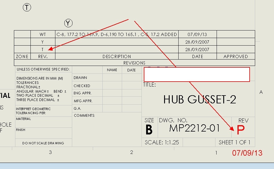

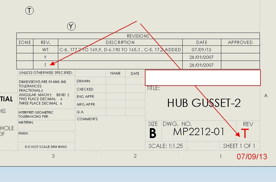

was wondering if anyone else ran into this 'glitch'. weareusing rev tables (no PDM) on our drawings, or trying to. wehave linked the note in the rev box on the titleblock to therev 'value'. however, we want to use a differentscheme thanwhat SW presents. now, if the rev table isorientated withthe title at the bottom, when i manually edited therev 'letter' or'number', the valve in the rev note does not update.HOWEVER, whenthe table's title is on the top, when i edit the revnote, the revupdates!!!
now the problem is, we would like the table title on thebottom.anybody else run into this, or can tell me what i might bedoingwrong....
