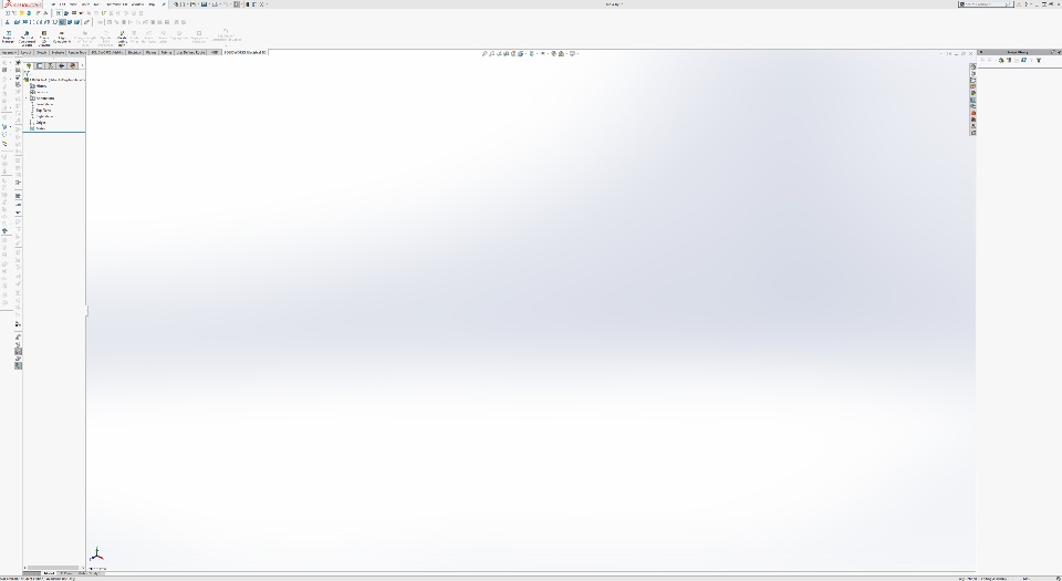

I am trying to import this STEP file from a supplier, but I have the same issue as this thread.

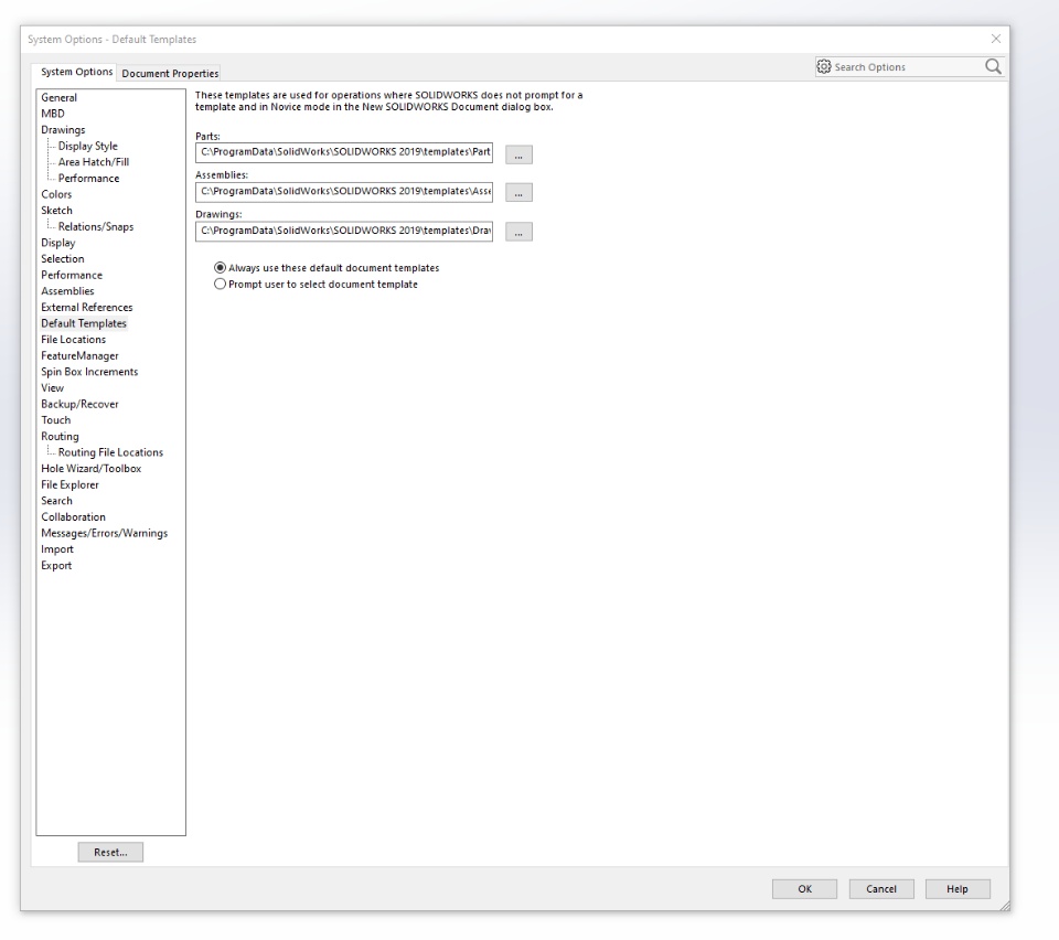

Every time I import the file, it goes through all of the parsing steps, then creates an assembly with no parts inside, entirely empty. In the thread I mentioned before, the issue was able to be solved with templates. I have mine at the default settings, and I have no clue what to change to fix this issue.
I've been able to convert the STEP into an STL which solidworks can open, but then there are a ton of gaps that wont' heal. I'm able to open the STEP file just fine with FreeCAD, so I don't think that its the file itself that is the problem.
If anyone can find out what the issue is, or can recommend a file format that will import properly, it would be greatly appreciated.
