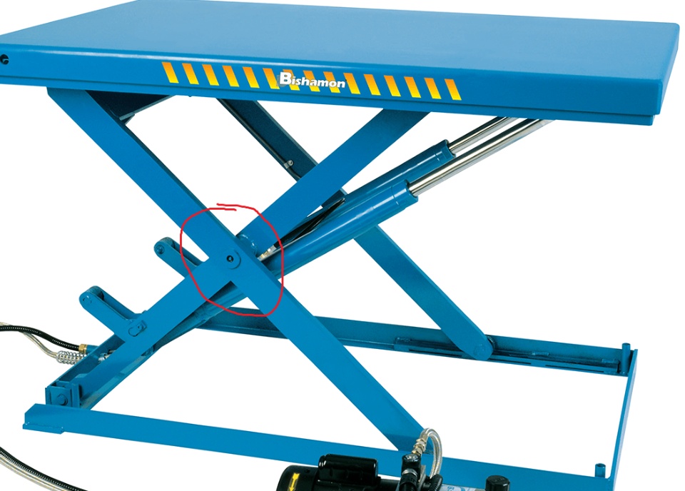

Hi, im trying to do basic stress analysis of scissor lift scissors but im not sure what kind of connections and boundaries i should use to properly simulate the connection between pair of scissors. In most of scissor lifts they are connected with a pin.  Should i even put a pin into simulation? Or just make pin connection between bushings of scissors?
I red circled the area im talking about.
Thank you for help.
