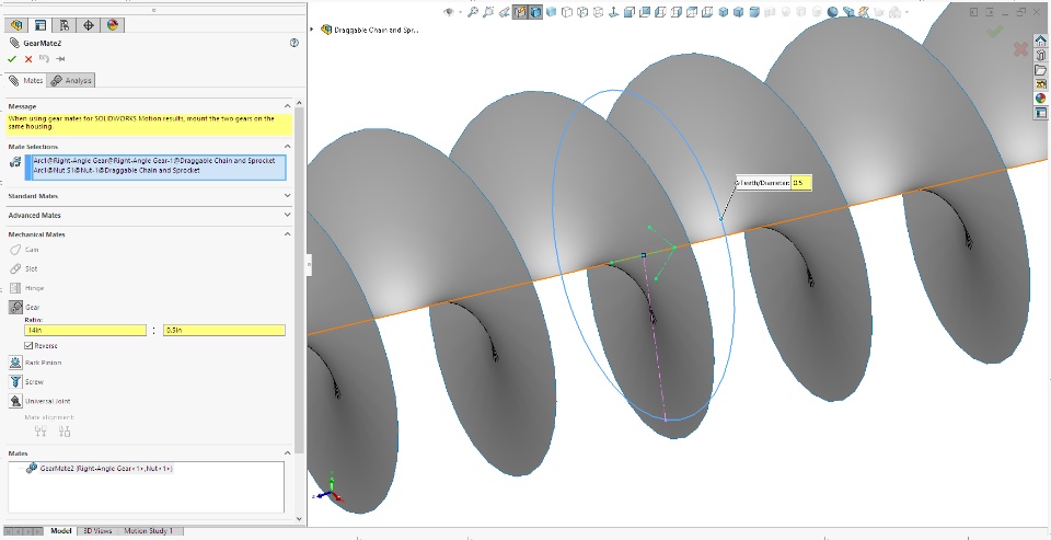

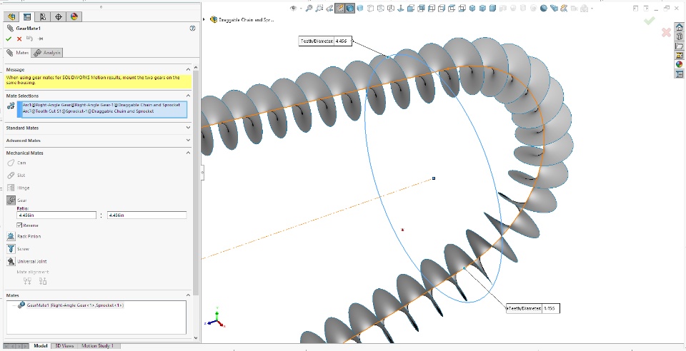

Here is a screenshot of the assembly with everything shown...
Here is what the Lead Screw Nut looks like...
Here is the Right-Angle Gear...
When the Sprocket spins by dragging, the Gear Mate will spin the Right-Angle Gear, which will then spin the Nut. The Nut will then follow along the Helix, similar to a Linear Rail.
It is basically a curvilinear Lead Screw and Nut. Once this is modeled, the Chain can be mated to the Nut and all will be in sync.
I have attached a sample assembly for reference (SolidWorks 2020). Make sure and drag the red dot on the smaller Sprocket for best results.

If you are wondering why there is an extra Right-Angle Gear mated to the Nut and Sprocket, it is because I found an anomaly with Gear Mates.
If the Nut is mated perpendicular to the Sprocket with a GearMate, the rotation of the Nut will speed up and slow down according to the size of the curve it is travelling on. It is a very strange thing to see.
Thus, instead of mating directly to the Sprocket, I had to put a 'middleman' in there.
The Right-Angle Gear ensures that the Nut has a parallel GearMate instead of perpendicular.
