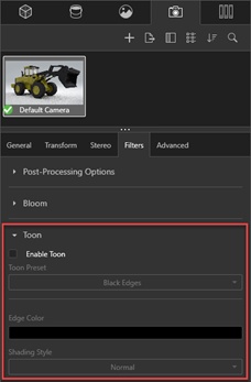

Toon settings are part of camera filters tab.  To access them, go to the Camera properties, Filters sub-tab and there is a small expander section for Toon.
As part of the Camera Filters properties, this means you can save toon settings to be used in other projects, and use them with configurations to achieve a variety of looks while always maintaining all your primary appearance assignments.
There is a primary checkbox to enable or disable toon for the given camera.
Followed by this there are some quick-selection presets for a few different styles, which simply use various combinations of the remaining controls: Edge Color, Shading Style, Toon Detail, and Color Override.

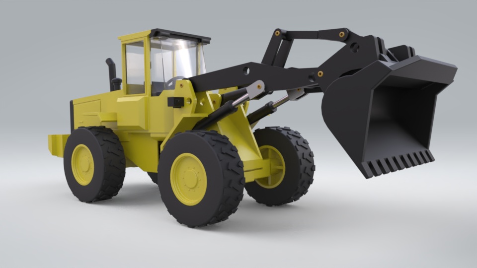

Toon disabled

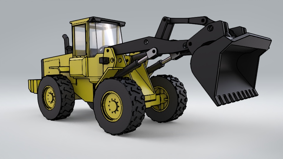

 Toon enabled.  Black Edges preset.  Edge color: Black Shading style: Normal

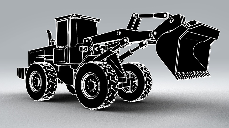

White on Black preset.  Edge color: White. Shading style: Toon Shaded.  Toon Detail: 0.  Color Override: Black.

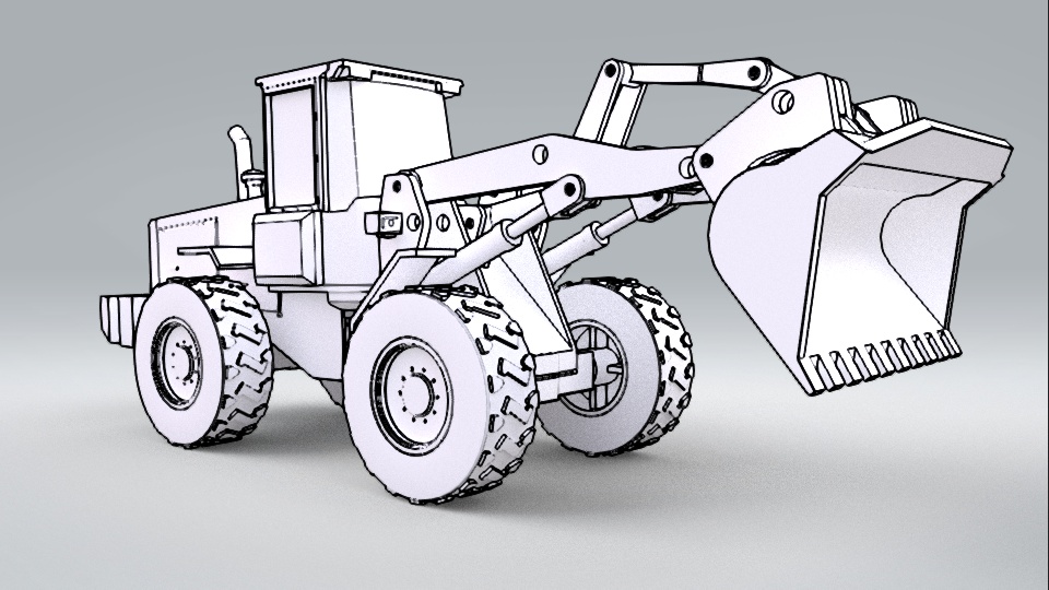

Ambient Occlusion preset. Edge color: Black. Shading style: Plain Shaded. Color Override: White

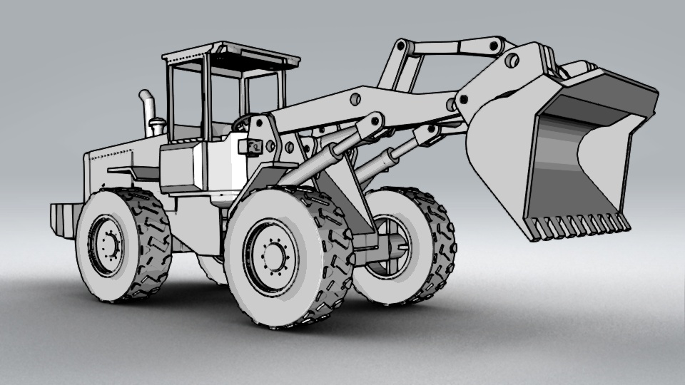

Custom settings. Edge color: Black. Shading Style: Toon Shaded.  Toon Detail: 10.  Color Override: White

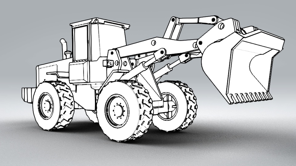

As previously mentioned, the toon edges can only have their color changed.  You cannot change line thickness or the way in which the lines are drawn.  Also, there is no way to have the faux toon shading style or plain shaded override by itself, without having toon edges on as well.  And while there is no toon specific setting to achieve a Toon Edges only look (transparent model), this can be achieved by setting a model (or just specific parts) to have opacity of 0.

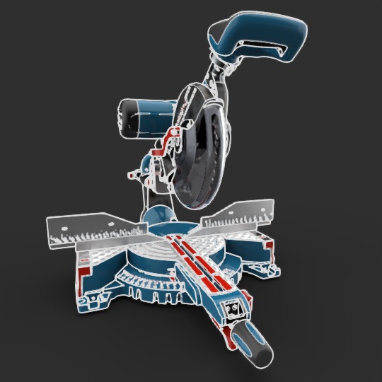

Hopefully you find the new Toon feature handy.  You can generate some non-photo realistic content which can be beneficial in providing early "conceptual" looking renders as opposed to giving an impression of a finalized design.  You can also use post, to combine photo-real and toon effects for some intriguing product illustrations.  Let us know what you think!!
