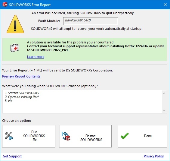

This hotfix (and follow-up SP5.1) will address a newly found crash related to legacy (pre-2018) custom properties using the “date” property\formula.
If any user encounters this specific crash, they will receive a notification directing them to download and install the appropriate hotfix, similar to this dialogue:
(More information about this functionality is found here: https://blogs.solidworks.com/tech/2017/10/solidworks-support-monthly-news-october-2017.html)
