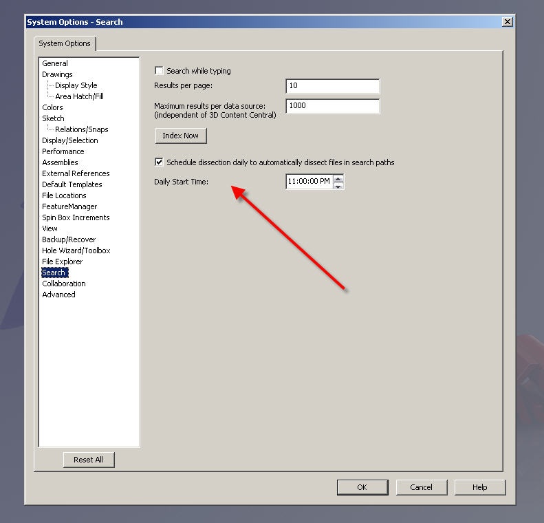

Small SW window taking up CPU time
"For some reason, unknown to me, a small window of SW appearsin the left corner of the screen (despite not having SW open orselecting anything) , with "click here to stop dissection" at thebottom. I don't know what it is doing, nor why it repeatedly openson its own. I have to force it to close too. Have you run acrossthis? Is it searching for a license? Any light you may shed wouldhelp since it ties up the processor and I can't do anything elsewhile it does this."
