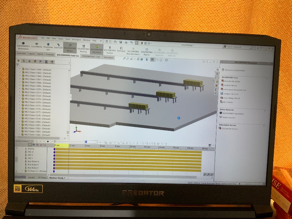

Hey, I just bought a new Acer Helios Predator 300, intel core i7 - 9750H CPU 2.60/4.3Ghz, RAM 16Gb, NVDIA GeForce RTX2060.
I am currently having a quite large assembly with 1510 components (approx 400 chains linked by Hinge mate, 6 sprockets, 6 beams, 6 conveyor bodies, and 15 boxes). I did find some little lags during the assembly process but nothing major. But, I have been trying to make the motion study. What i got is; to calculate and render a 5 second motion analysis, it takes approx. 10 hours. Which is crazy i believe.
is there any way I could reduced this calc and rendering time?
Motion analysis properties:
1. Frame per second: 25
2. Precision 0.001
3. Medium to High contact precision
4. 6 driving motor (3 sprocket and 3 roller)
5. 9 solid body contacts between quite large groups of objects.
6. Gravity as usual
