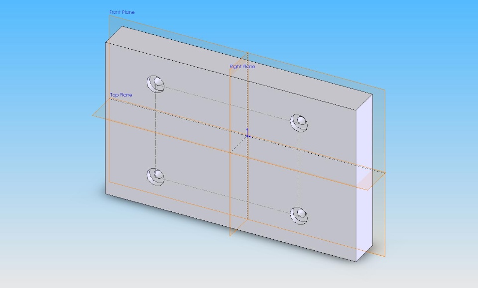

For years I've been using Solidworks and I've never understoodthis.
Example: When creating a specific hole pattern, 2 taps and 2 dowelsthat form a rectangle pattern, I like to create the rectangle forconstruction geometry. (See Attached Pic). This makes it easierselecting the opposite points for the taps or dowels in theopposite corners later.
But when you are in point mode creation for holes, the system givesyou an error saying it can't apply it to an existing point ( a lineendpoint). But you can put it beside it and then add a relation. Tome this is broken and should be addressed. Also, there is no way tosuppress or turn off sketch points in the hole wizard for differenthole configurations.
