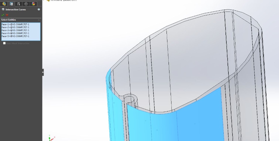

1st step - Referencing from geometry as I indicated without any flat face by intersection curve

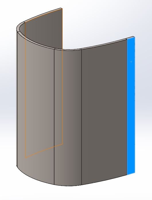

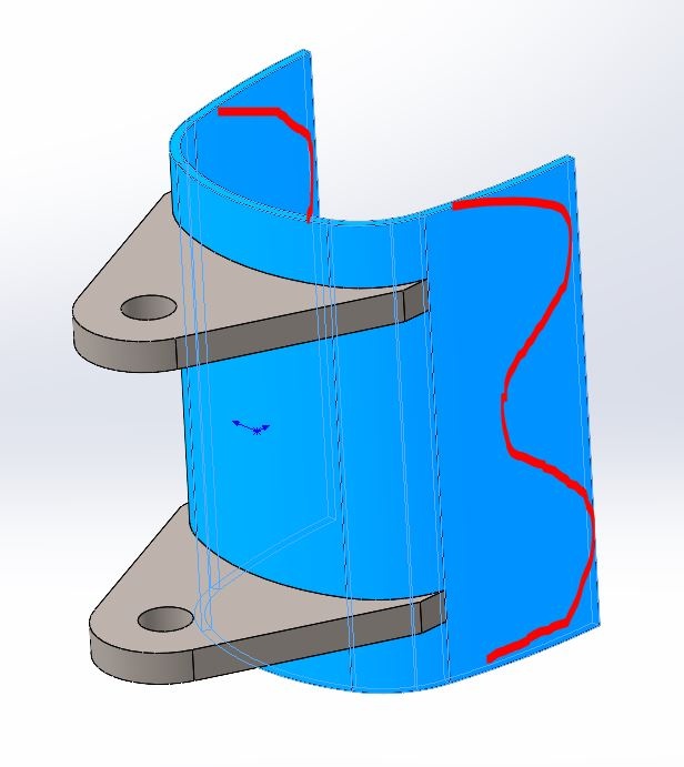

2nd step to base flange and extrude it to a specific dimension and try to cut extrude the side edges with a red color sketch.

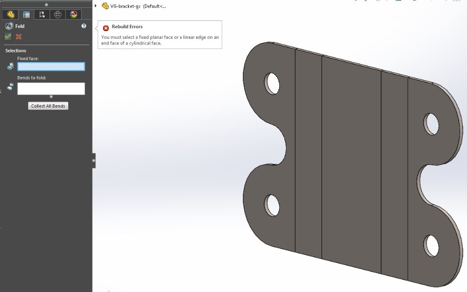

3rd step - In order to cut the side surfaces; since I cannot use flatten as it will suppress my modifications after the unflattening process, I tried to use Unfold command. This command requires a fixed face (which I have only arc faces) tried to manipulate the program by adding one more short flat surface to be able to get the fixed face.

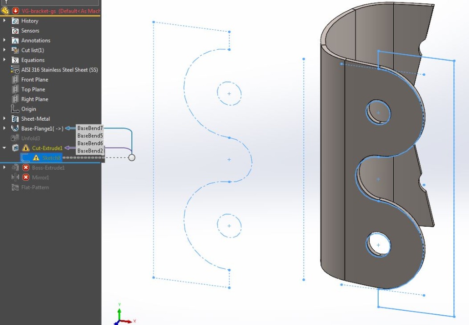

4th step - Unflattening and make some modifications, but finally, I couldn't figure out how to unfold it again as I have already cut my flat surface :/

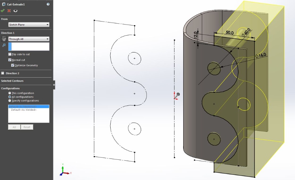

5th step - As a plan B- I suppressed the unfolding and try to cut extrude again with using normal cut with the sketch that I want to use from the flatted surface
6th step - The final result was a broken far edge surface in below image whereas I could get closer what I want which in flatten the view.
I could, of course, split from the middle and mirror it however the holes and other circular dimensions will have a projected line which will not be precise and accurate. This below image is just to show what my requirement will look like (at +Z axis direction)
