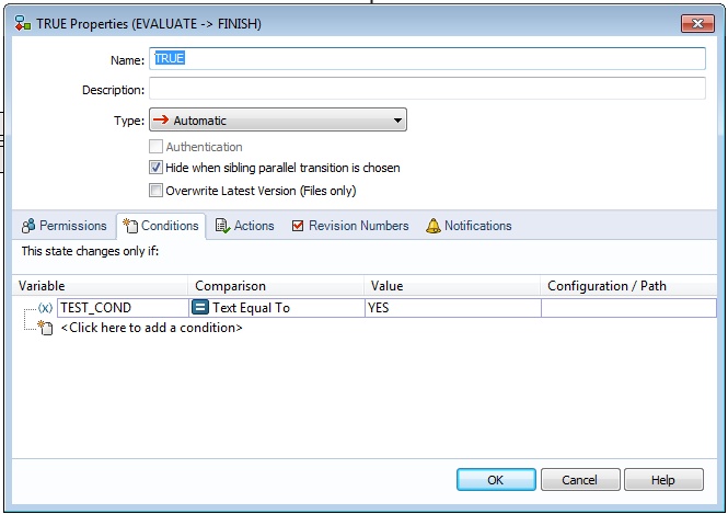

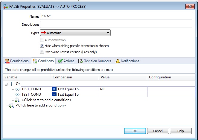

The ‘TRUE’ and ‘FALSE’ automatic transitions have the following conditions:
I’ve attached a .cex file of the workflow.
The problem I am having is that the EdmCmdType.EdmCmd_PreState and EdmCmdType.EdmCmd_PostState are firing differently in 2020 compared to 2017.  I created a simple test add-in that hooks into these two events and prints out the source and destination states.  I’ve attached the Visual Studio project files.
 I create a test file in my vault and use the SEND transition to start the process.  Since the file does not have a value for the TEST_COND variable, it should end up in the AUTO PROCESS state and indeed this does happen in both the 2017 and the 2020 vaults.  However, the actual events that are fired do not match what happens to the files.

When I run this in my 2020 vault the output looks like this:
Pre State Event: source=START destination: EVALUATE
Pre State Event: source=EVALUATE destination: FINISH
Post State Event: source=START destination: EVALUATE
Post State Event: source=EVALUATE destination: FINISH
The 2017 behavior is correct.  The 2020 behavior is wrong.  My real add-in is heavily dependent on the pre and post state event hooks.  It is unusable now.
