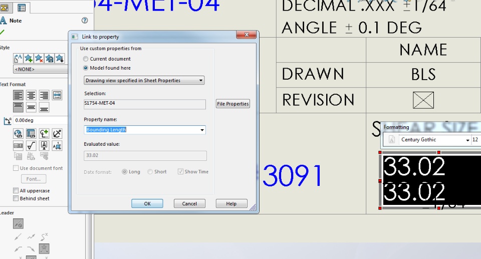

Any suggestions of why this sheet metal property always displays the number twice? Even on new text boxes where I can be sure I don't already have the property in it it shows up and on every sheet metal part I do it with. It also only happens with Length, not Width. It is also always two lines even if the textbox is extended and appears as a single link property in the textbox.

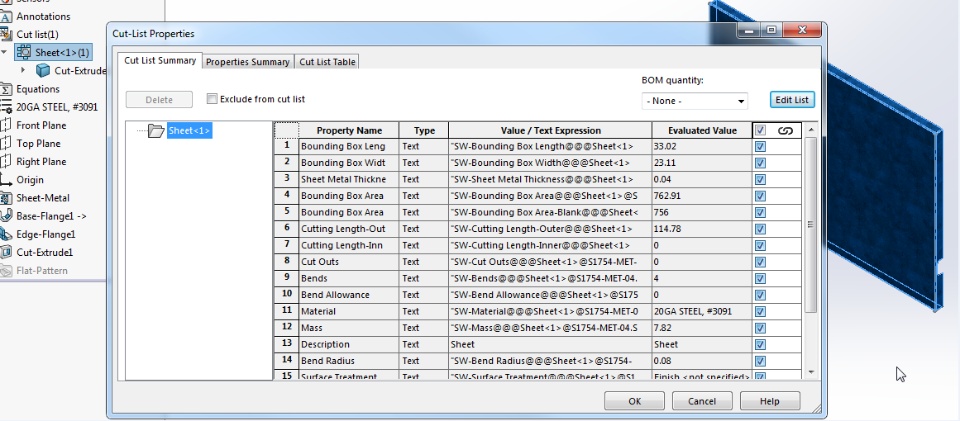

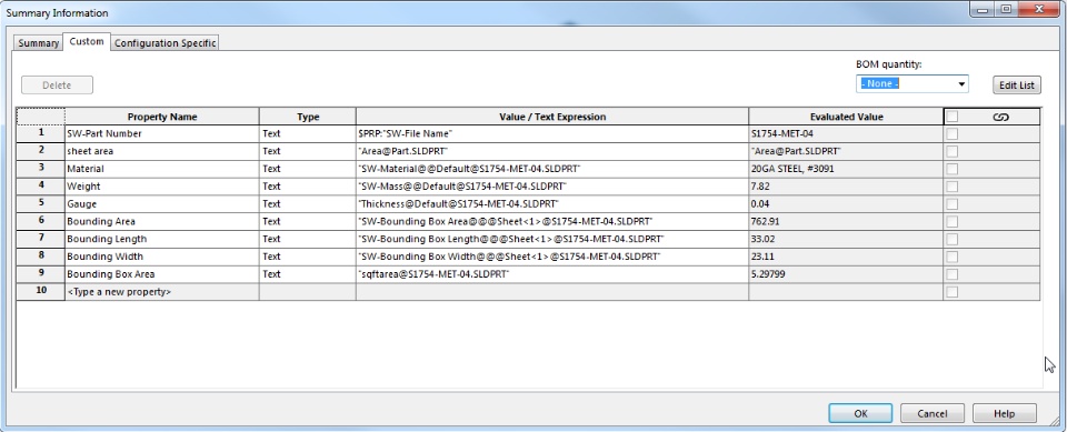

I had been populating the Length and Width property with a macro by Deepak Gupta fromt his forum for 2017, but it stopped working consistently with this version of Solidworks for me. Instead I've been using the cutlist property linked to a custom property that I can call out in my drawing template.
Also, if anyone knows how to format this value so that it's always 2 decimal places in my template or in properties, that would be fantastic. The number in cutlist seems to be a different format than other properties. As if it was a string and they were numbers or something along those lines, I can't remember specifically from the last time I tried to deal with it, but it avoided my attempts to format it how I liked. (Not shown, but after I hit enter it becomes 33.019)
