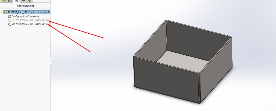

Hello. I am trying to save a flat pattern, but I need configuration name to be in exported DXF
I am trying to make a code, where name of exported DXF consist of:
File location + Name of Active Configuration + Custom Specified property of configuration  + ".dxf".
Exported dxf should save to the same folder where the active file is.
Is it possible to make?
