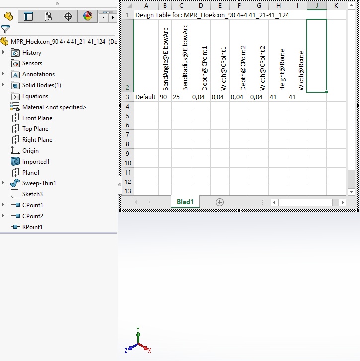

I'm trying to make custom Routing parts, and for the most part everything goes smooth.

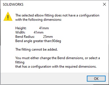

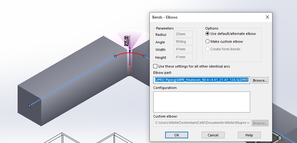

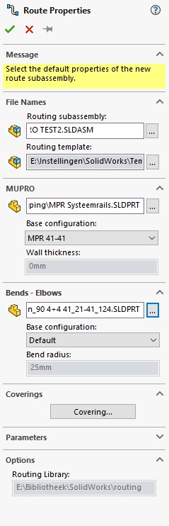

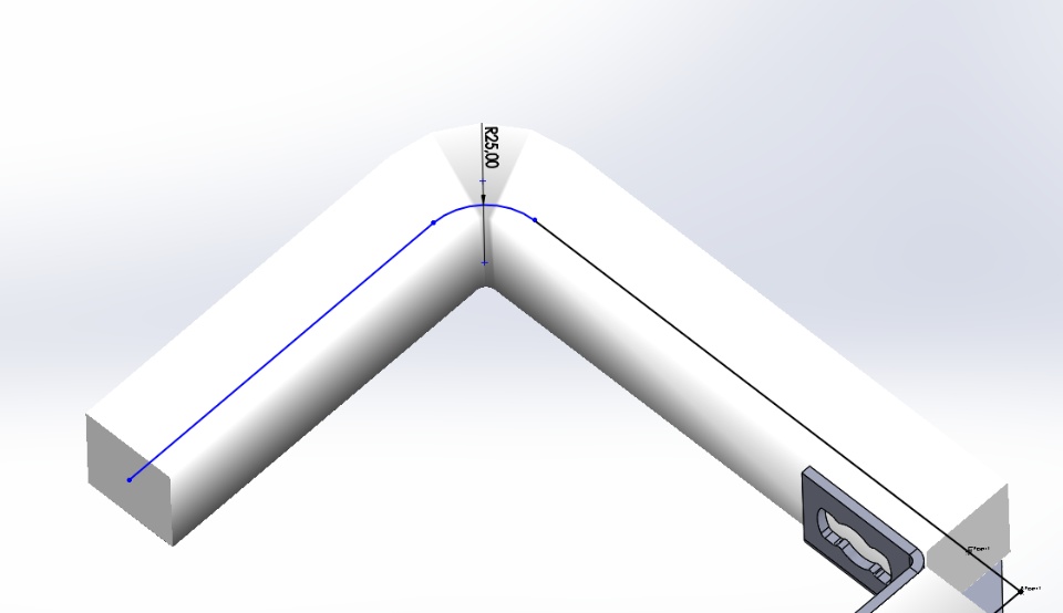

The system recognizes I have a Elbow part (See Picture1 and Picture2). But when I try to close Sketchmode, it gives an error that the Elbow fitting does not have to correct configuration, and gives a list of specifications the fitting needs to have (Picture3 and Picture4).
However these are exactly the same dimensions as my part has...
I also added a picture of the Design Table of my Elbow part (Picture5).
Does anyone else have this problem or know a solution?
