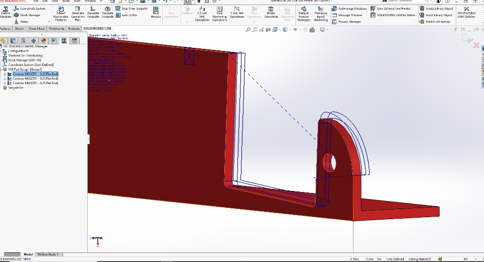

I am making a cam file to export a g code and I am coming across an issue. The problem is i am milling on open profile and i do not know how to clear the tool after the first cut when it goes back to make the 2nd cut. When the cutting tool completes the first pass it goes to make a 2nd and wants to cut the material when it travels back. dotted line in photo. What setting can i change to have it clear the material?
