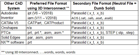

I am sure there are folks at SWX that have probably already done this. I am just asking for it to be published and explained here. Here is a rough idea of what I'm talking about:
Notice that nowhere in here is IGES listed as a preferred format. ACIS and STEP are actually tertiary choices, but generally acceptable. If it is explained that IGES is a poor choice then people will remember that and avoid using it. If 3D Interconnect is better explained here then more people will take advantage of it. Linking to the online Help is okay, but that should be only for supplemental information.
